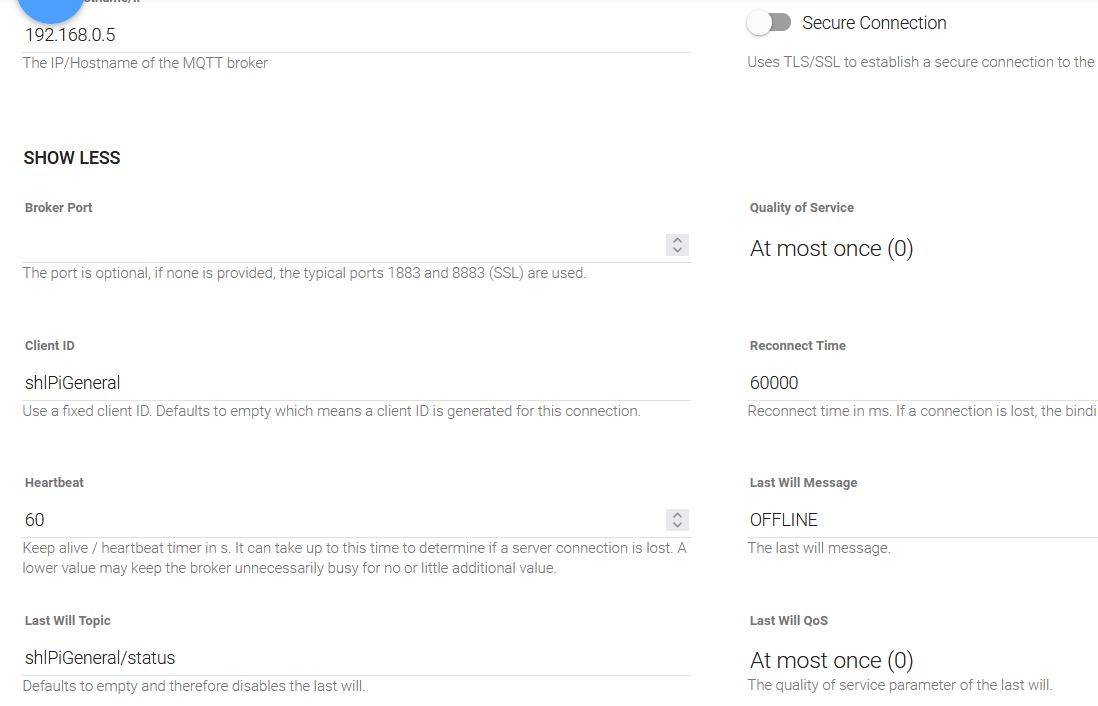

On the VM I have created a thing with this configuration:
And on the Raspberry Pi`s as example a thing with this configuration:
What works is that it is online:
You can check it if you will disable or uninstall the mqtt-clients. So it is possible that you only have to use one MQTT-Broker (not the MQTT Broker things) and multiple mqtt-clients. But on each device you should have to create a thing to connect to the MQTT-Broker, as you can see above, with the external address to this one.

On the Raspberry Pi Xs I use of coure 192.168.0.5 for IP of the MQTT broker, port 1883, as Client ID shlPiGeneral, shlPiBad, shlPi… The Last Will Message are also OFFLINE. Last Will Topic was also the Hostname/status. On all MQTT Broker things I use Quality of Servie 0, Reconnect Time 60000, Heartbeat 60 and so on. The default settings. Of course no username and password. All things are Online if the mosquitto broker is started. Good sign. If I uninstall the mosquitto-clients on one Raspberry Pi`x the thing goes offline. If I reinstall it, it goes online again.
On all devices the things are named MQTT Broker. What is different is the Thing ID: mqtt:broker:mosquitto on the VM, mqtt:broker:general on shlPiGeneral, mqtt:broker:bad on shlPiBad and so on. Well it`s not really important.
