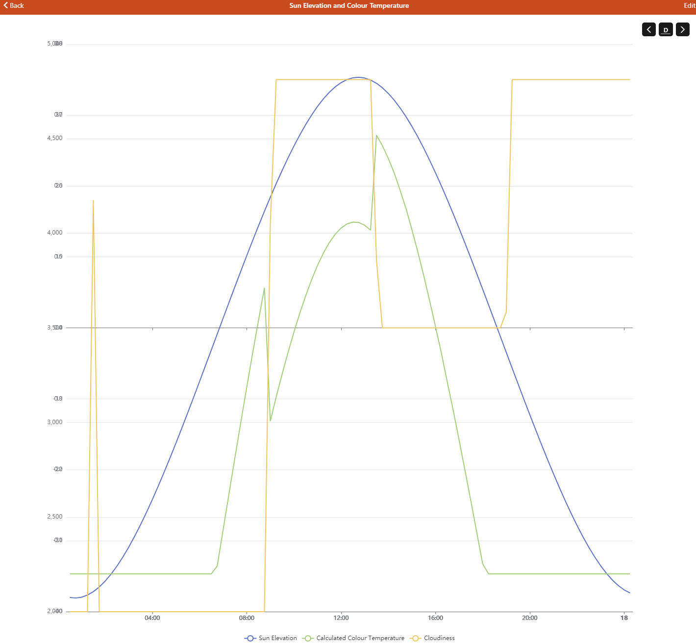

Color Temperature by Sun elevation
The reason I am using such a convoluted ON command in genericCctLight_On, is because I have another rule I run that sets a global color temperature based on Sun elevation to a Calculated_ColorTemperature item, and then send this value to any light that is ON. I love this rule, but I’m sure it could be prettier than this, and rewritten in DSL.
You might also notice that I’ve not included the Cloud_Factor in my final output as I was experiencing massive steps because the local weather data was very coarse data. I want to make it only take a maximum step of about 100K each time the rule is run.
Maybe someone can help with this?

var CloudFactor = output * Clouds * 0.003;
var newColourValue = Math.min(Math.max(output, 2200), 5600)
events.sendCommand('Calculated_ColorTemperature', newColourValue);
