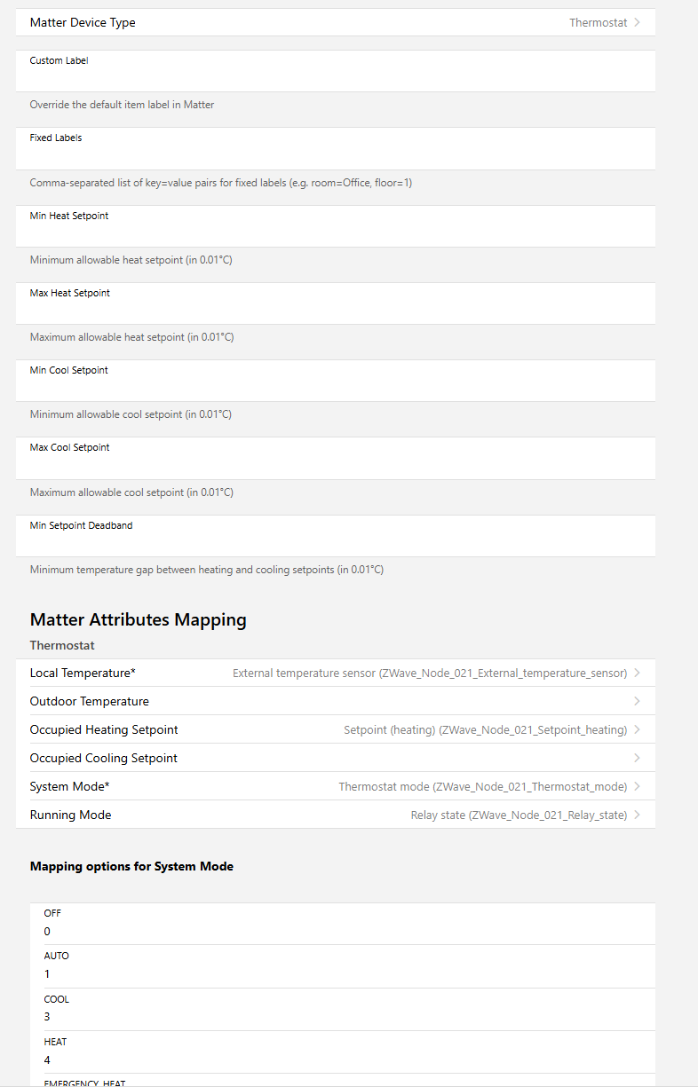

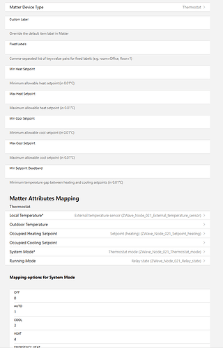

  1. I have a couple of z wave devices for thermostat for example. When I add the metadata for matter than there is a mapping.(see #1) This mapping is later on complained by the matter binding.(see #3). So this does not work.
  2. I tried the fixed labels tag. But somehow they are not taken into consideration by apples iPhone. – When I pair the matter binding with the homekit within iphone, the rooms I assigned in openhab are not considered. Everything goes into Standard room. Nevertheless, the labes are considered.
That is what I can tell so far I try to get some screenshots to show what I am trying to explain

  1. item configuration in UI on openhab:

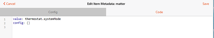

  1. How to enter mapping in YAML Code — could not find a good example
  1. Error in matter binding within UI
Error: org.openhab.binding.matter.internal.client.MatterRequestException: Error: Error initializing oh-bridge.aggregator.ZWave_Node_021.thermostat Cause: Error: Validating oh-bridge.aggregator.ZWave_Node_021.thermostat.state.systemMode: Conformance ā€œAUTOā€: Matter does not allow enum value Auto
