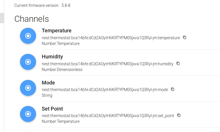

This is how I play it - things are created in PaperUI
In some cases, I’ll let PaperUI generate items too, but from here on, all item and rules config is done in files.
I run openhabian and the backup and restore scripts have been very good at teardown, rebuild and migrate of my environment..
Make sure you have some idea how to use the karaf console - and if in dire need, you can always fall back on the API to identify any spurious records.
The biggest downside is that I sometimes end up with duplicate items linked to channels and occasionally add channels, that I am fairly certain I will never need
