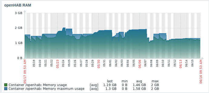

There have been a couple of threads about the apparent large size of Docker containers. Mine seems to sit at around 1.2 BG with 1.3 GB max over the past day. It’s pretty stable but I’m not doing much of anything with OH right now beyond letting it run these days. Looking over the past month it looks like It’s been around 2 GB at times.
I don’t know the causes for it growing and shrinking. I run the SNAPSHOTS and upgrade a couple times a week so there are caused by restarting OH dues to the upgrades or or something else. It’s running on a VM running on an old (now Intel i3 processor). The host has 32 GB ram but the VM OH is running on only has 4 GB.
As an aside, I’ve learned a whole lot about my system after having installed and configured Zabbix. It was well worth the effort to install and set up.
Anyway, what you describe sounds more like a bug or memory leak or the like. I don’t remember there being anything reported in the 2.5.9 timeframe so it’s most likely a binding but could be almost anything.
Hi thanks…is zabbix where you get those pretty stats from?

Mine seems to have retreated from original start up values…and longer term I will look at a new mini pc, but with 8gb ram.
Yep. But it’s a project in an of itself and not at all light weight. But it’s been worth the effort for me. I discovered one of my RPis was silently rebooting itself every couple of hours without my knowledge. Turned out it needed a better power supply.
It also showed me that about every couple of hours one of my VMs was hitting a sustained load of 8-10 about twice a day. I was able to narrow that problem down to crappy default PostgreSQL settings. Of course this was a case where everything was fine until I installed Zabbix and PostgreSQL started to get pounded a lot more. That helped bring the load down to a sustained 2 with spikes to 4-5 so I got a new RPi 4 and moved a few services (vaultwarden, heimdall, and guacamole) off of the VM to the RPI 4. I also move my virtual desktop to the new RPi 4 and now everything is much happier with loads under 1 with spikes to 2.
It’s still telling me that my HAProxy on my pfSense firewall is restarting sporadically and for no apparent reason which I need to track down. I’ve also some weird inefficiencies on my network
I’m able to set triggers that generate an email (can be just about any kind of notification like Telegram or SMS) so I’m immediately informed when something goes wrong. I have it running on all my VMs and all my RPis. Pretty much everything that is always running.
