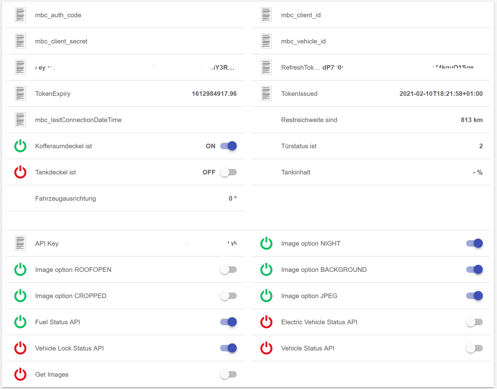

I’m not sure yet what the reason is, but it can’t be too much more. Some data like rangeliquid, doorlockstatusvehicle, positionHeading work great.

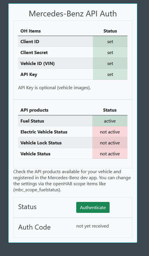

The auth process looks very stable.
I am also successfully calling the following endpoints:
“Fuel Status API”
“Electric Vehicle Status API” * implemented but not tested
"Vehicle Lock Status API
"Vehicle Status API
“Pay As You Drive Insurance API”
I have already implemented and tested some error queries and working on stability.
Some parameters like “roof open” and “hv battery capacity” I can’t test because my vehicle doesn’t provide these parameters, however they are implemented.

i have also improved the auth website, increased the security of the auth process and eliminated errors that can happen in some situations
