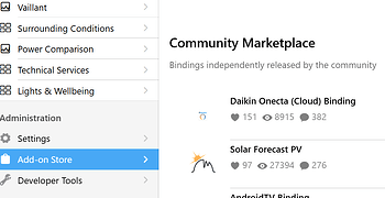

Sure, openHAB releases are done each 6 months, some patch releases in between.

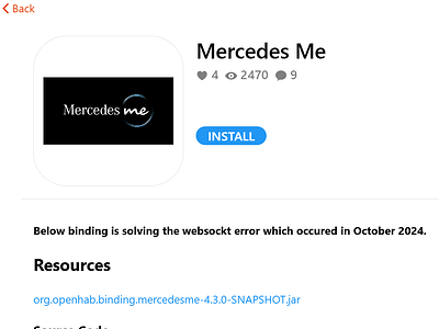

For such urgent problems we’ve the opportunity to place an addon in the Marketplace, pic 1. If you you click on MercedesMe you’ll see pic 2 - voila!
Pic 1
Pic 2
so you suggest to keep installed the version in the marketplace?
Not keep, reinstall. I changed the binding to this version yesterday and they are not updating automatically. So first remove and then install again.
