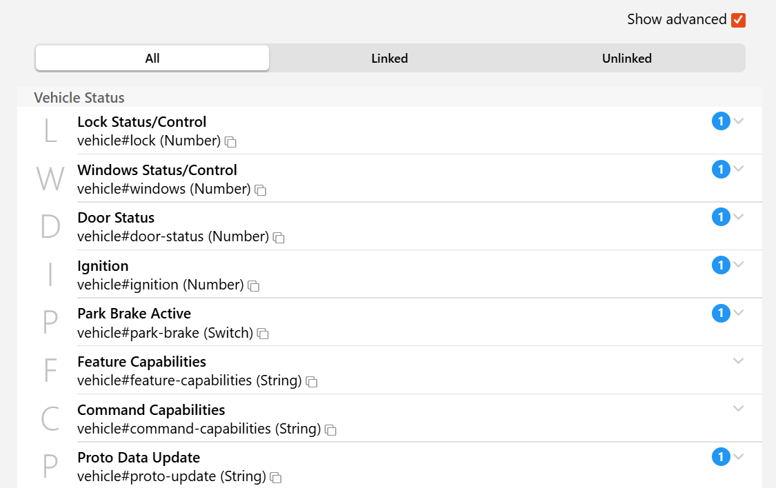

Can you attach an item to proto-update advanced channel and send the content to me per DM?
THX, found it: “tankLevelAdBlue”:{“display_value”:“29”,“timestamp_in_ms”:1731353728000,“ratio_unit”:“PERCENT”,“timestamp”:1731353728,“int_value”:29}
Will exptract it for the time being by transformation profile.
May be you can include this information offically in your binding.
Thx in advance, O.
Please check binding linked in top post.
