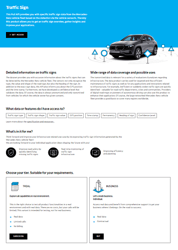

On the official supported data from Mercedes link that you provided, you had explicitly checked the ‘BYOCAR’ package. I am not sure what ‘BYOCAR’ is actually, but if you deselect it, the web page seems to imply that many if not most of the data that is available in Mercedes Me could also be available via the API.
BYOCAR is Build Your Own CAR and these APIs are free to access for everybody.
Select any other product and you’ll have and / or
  • sandbox version which provides only sample data
  • trial version with strictly limited calls
  • business version you’ve to pay for
See Traffic Sign Product with only Trial and Business version
I love to have these data but
  • sandbox data is useless for my specific vehicle
  • trial will simply stop after a certain amount of queries
  • business I don’t want to pay for data of my vehicle

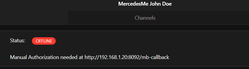

This is not obvious to me → Purpose URL: use link towards this binding description ←
What link, do i need to find further down in the readme ??
EDIT: is it this link → GitHub - weymann/OH3-MercedesMe-Drops: Development Drops of openHAB MercedesMe binding ← ??

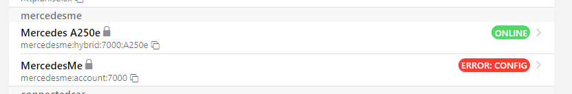

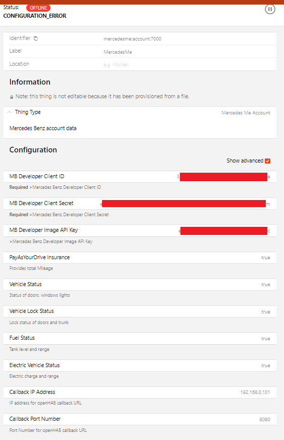

Im trying to use the file based configuration.
I have made a new MercedesMe configuration for this binding, at first i tried to use the same on as i used with @spawny0815 solution.
But anyway i think its a problem with in Openhab, i get these errors.
2022-06-26 09:21:17.264 [INFO ] [g.mercedesme.internal.AccountHandler] - Config delivered ID 3xxxxxxxxxxxxxxxxxxxxxxxe, Secret exxxxxxxxxxxxxxxxxxxxxxxxxxxxxxxxxxm, IP not set, Port 8090, scope offline_access mb:vehicle:mbdata:payasyoudrive mb:vehicle:mbdata:vehiclestatus mb:vehicle:mbdata:vehiclelock mb:vehicle:mbdata:fuelstatus mb:vehicle:mbdata:evstatus
2022-06-26 09:21:17.267 [INFO ] [g.mercedesme.internal.AccountHandler] - Config to edit Configuration[{key=fuelScope; type=Boolean; value=true}, {key=odoScope; type=Boolean; value=true}, {key=evScope; type=Boolean; value=true}, {key=clientId; type=String; value=3xxxxxxxxxxxxxxxxxxxxxxxxxxxxxxxxxxe}, {key=imageApiKey; type=String; value=exxxxxxxxxxxxxxxxxxxxxxxxxxxxxxxxxxc}, {key=callbackPort; type=BigDecimal; value=8090}, {key=lockScope; type=Boolean; value=true}, {key=callbackIp; type=String; value=192.168.0.101}, {key=clientSecret; type=String; value=exxxxxxxxxxxxxxxxxxxxxxxxxxxxxxxxxxxxxxxxxxxxxxxxxxxxxxxxxxxm}, {key=vehicleScope; type=Boolean; value=true}]
2022-06-26 09:21:17.285 [INFO ] [g.mercedesme.internal.AccountHandler] - Config not valid

EDIT: from the mainUI things, it seams that some of the configuration is running.
Configuration seen from mainUI

Everything right on yor side. There’s a bug in my code when Bridge is initialized the first time. I fixed it already in the Marketplace version.
For you I think simply deactivate and activate your Account Bridge should do the trick. It’ll not go online but should forward you to the last setup step - the manual authorization

I did the disable / enable in mainUI, after this the callback thing was available :slight_smile:
Now everything worked as described in the readme, i cant test fully because the car is a the dealer for service, i guess when they start working on the car items will be updated :slight_smile:

There’s 100% no magic in this binding especially there’s no way to autodetect the Mercedes Developer project - otherwise I would implement this. But I know this is procedure is error prone and it’s worth to double check each step.
  • double check your configuration settings are saved
  • after this open the callback page in order the right scopes are set
In order to make it more transparent the callback page shows now the selected scopes too.
