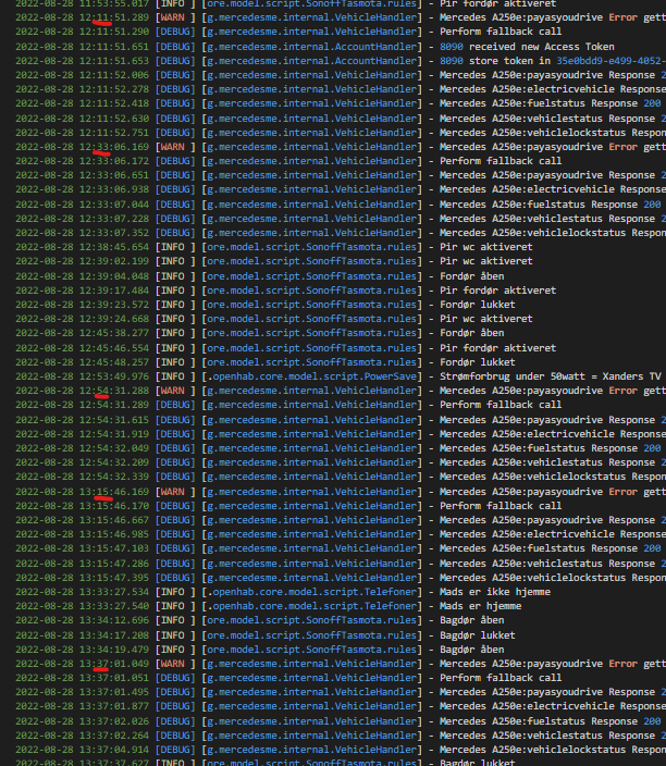

HI @weymann
ƍ just had a look at the log file, the fallback is applied every time from 1015 until now.
2022-07-01 19:10:52.098 [WARN ] [g.mercedesme.internal.VehicleHandler] - Mercedes A250e:payasyoudrive Error getting data java.io.EOFException: HttpConnectionOverHTTP@7d45::DecryptedEndPoint@bdfbd5{l=/192.168.0.101:44598,r=api.mercedes-benz.com/159.122.71.196:443,OPEN,fill=-,flush=-,to=1282123/0}
2022-07-01 19:10:52.100 [DEBUG] [g.mercedesme.internal.VehicleHandler] - Perform fallback call
2022-07-01 19:10:52.628 [DEBUG] [g.mercedesme.internal.VehicleHandler] - Mercedes A250e:payasyoudrive Response 200 [{"odo":{"value":"23919","timestamp":1656687757000}}]
2022-07-01 19:10:52.927 [DEBUG] [g.mercedesme.internal.VehicleHandler] - Mercedes A250e:electricvehicle Response 200 [{"soc":{"value":"62","timestamp":1656687500000}},{"rangeelectric":{"value":"39","timestamp":1656688173000}}]
2022-07-01 19:10:53.195 [DEBUG] [g.mercedesme.internal.VehicleHandler] - Mercedes A250e:fuelstatus Response 200 [{"rangeliquid":{"value":"144","timestamp":1656687816000}},{"tanklevelpercent":{"value":"22","timestamp":1656687816000}}]
2022-07-01 19:10:53.318 [DEBUG] [g.mercedesme.internal.VehicleHandler] - Mercedes A250e:vehiclestatus Response 200 [{"windowstatusrearleft":{"value":"0","timestamp":1656666812000}},{"windowstatusrearright":{"value":"2","timestamp":1656667862000}},{"doorstatusfrontleft":{"value":"false","timestamp":1656688800000}},{"doorstatusfrontright":{"value":"false","timestamp":1656688752000}},{"readingLampFrontLeft":{"value":"false","timestamp":1656688809000}},{"readingLampFrontRight":{"value":"false","timestamp":1656688809000}},{"windowstatusfrontright":{"value":"2","timestamp":1656651882000}},{"doorstatusrearleft":{"value":"false","timestamp":1656651867000}},{"windowstatusfrontleft":{"value":"2","timestamp":1656651882000}},{"decklidstatus":{"value":"false","timestamp":1656688567000}},{"doorstatusrearright":{"value":"false","timestamp":1656595136000}}]
2022-07-01 19:10:53.513 [DEBUG] [g.mercedesme.internal.VehicleHandler] - Mercedes A250e:vehiclelockstatus Response 200 [{"doorlockstatusvehicle":{"value":"2","timestamp":1656688802000}},{"doorlockstatusgas":{"value":"false","timestamp":1656688802000}},{"doorlockstatusdecklid":{"value":"false","timestamp":1656688802000}},{"positionHeading":{"value":"96.0","timestamp":1656687817000}}]
As you can see the fuel data is coming
through, took the car for a spin in sports mode = Electric + Gasoline engine
From log file i noticed there around 20min between updates, things is configured with 5min.
Thanks Mads

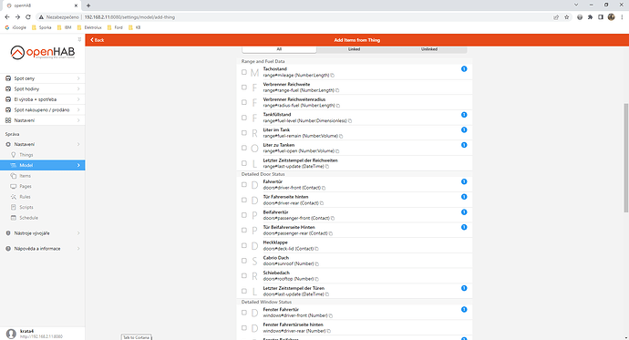

Hello, thans for that. It is working.
I would like ask you whether I can switch binding to english? Because I have all labels in German.
Jirka
Nice to see it works for you!
For translation I’m a bit clueless right now. I definitely had a naming issue in the translation file which is fixed now. But I’m not able to get the english version running on my system changing
  • openHAB language settings and / or
  • raspi Locale change
Both performed with clean-cache and reboot. Please give the new version a try and give some feedback!
Partial success :slightly_smiling_face:
  1. Things are translated - this is OK
  2. Channales not translated
Jirka

Hi @weymann
Question regarding update interval, i have refreshInterval=5 but it seems like its ignored ?
example from log:
12:11 next 12:33 = 22min
12:33 next 12:54 = 21min
15:54 next 13:15 = 21min
13:15 next 13:37 = 22min
Regards Mads
Just checked on my side: switched from 5 min to 1 min and back again and this worked fine for me.
I see in your screenshot the response from Mercedes API is printed as DEBUG log. This is an older version and in the meanwhile the binding has gone through the official openHAB review process with several findings fixed. The Pull Request is merged and the binding will be part in the next official OH release. If you want to see the API response messages you need to set loglevel TRACE.
Long story short:
Please remove jar file from addons folder, download again the jar from top post, it’s linked to latest version and check again with the newest version.
