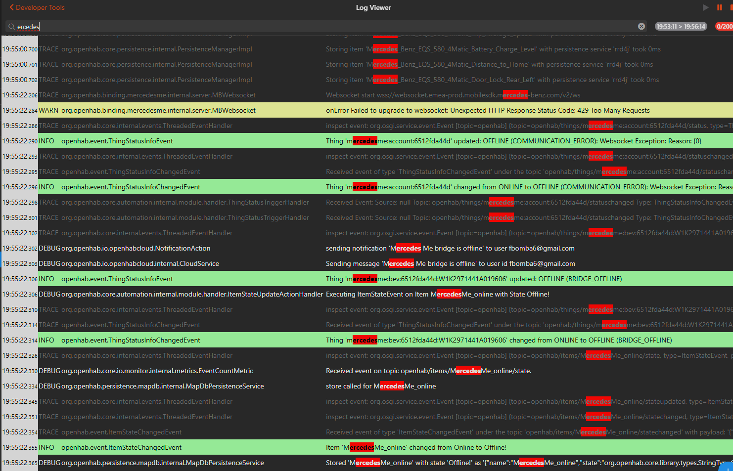

I am running Version 4.3.2 of openhab. I now get the following Error. After that both Things are offline.
[rcedesme.internal.server.MBWebsocket] - onError Failed to upgrade to websocket: Unexpected HTTP Response Status Code: 429 Too Many Requests
Any hint?
I have been seeing these problems intermittently, with the bridge flapping between offline and online every few hours, since Thursday January 9. I am running OH 4.3.1 but this “Too Many Requests” looks more like some form of connection throttling by the Mercedes server side…
@Boris_Fierlings @F18i
Yes, had this too yesterday for some hours with respone 429 - too many requests. Came “out of the blue”, nothing changed in system. Self healed in the evening.
Yes, looks like it’s gone. Have had the Errors the Last 3 days. What ever happend in the Mercedes Cloud.
Yesterday I set up an alert with notification on status changes for the bridge and I can still see it flapping from online to offline every ~2 hours.
So unfortunately it doesn’t seem like the problem was temporary and it did not really go away. It still definitely seems an issue on the Mercedes server side.
Is there anything that can be changed on the bridge connection code to make it more tolerant of this particular error? Maybe implement or tweak the retry logic? Thanks in advance!

I enabled tracing level logging and it really does not show a lot more than what we already knew, i.e. the “429 Too Many Requests” warning.
However, I also found out that I originally set the Bridge “Refresh Interval” to 5 minutes. Since I changed that back to a more conservative 10 minutes this morning, I have not seen any disconnect. So my hypothesis is that some requests to the backend remain in flight for more than 5 minutes and the following one gets rejected with that 429 error, causing the bridge to disconnect.
Anyway, for now it appears like my problem has gone away. If we all see this coming up again, I suggest experimenting with the refresh interval parameter.
My logs look the same. I have 5min refresh. What do you have?
Yesterday I set the refresh interval to 10 minutes and, since then, I have not seen any more disconnects.
