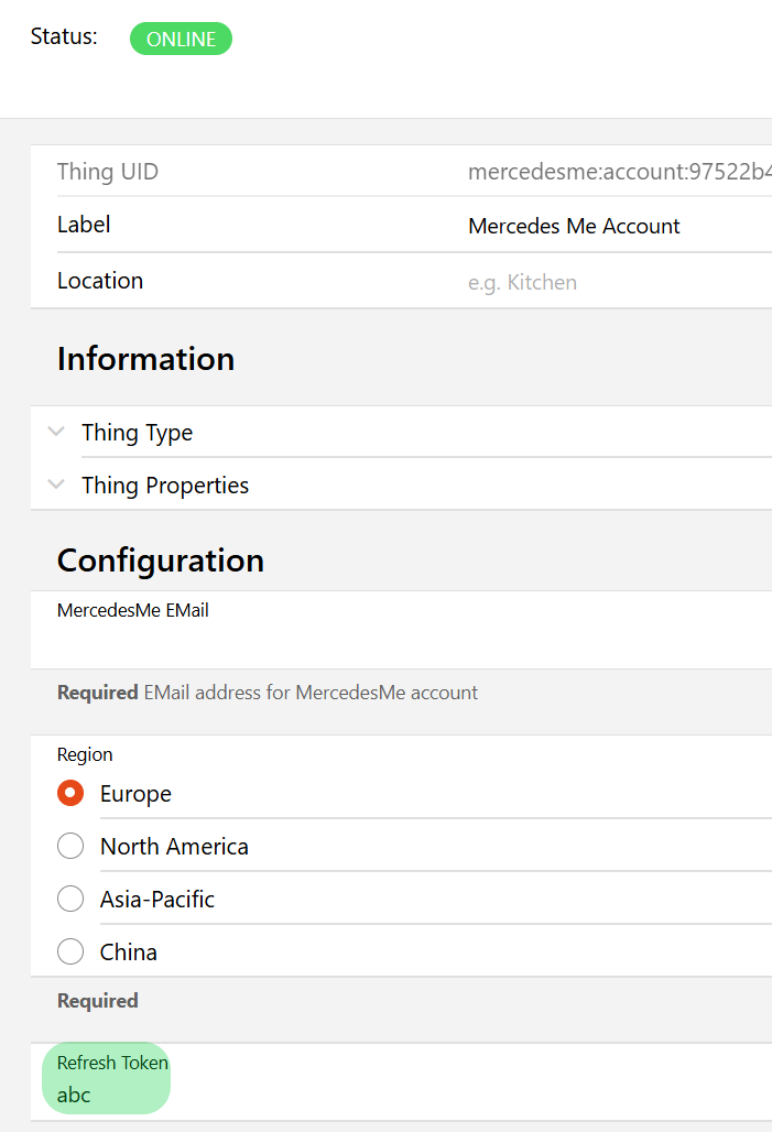

For those already running this binding
You can enter abc or whatever you want into the mandatory refreshToken field. If the stored token is valid this will work. Otherwise follow the readme process.
