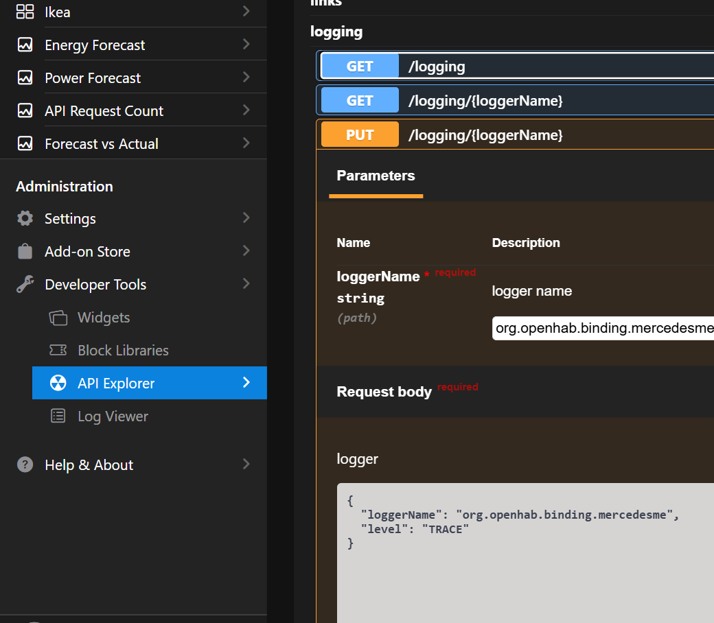

Dear Bernd, thank you very much for the fast feedback. As I have for “add-on settings” only an emty page, I can’t change to TRACE settings. Before the installation of the binding from yesterday I had as well installed other version’s of the binding. From marketplace and as well *.jar files. Uli
Right, that’s curious. I double checked all my installed Marketplace Bindings and none of them have the option to change log level. If I drop them into addons folder I can change it! Seems I need to file an issue!
But you can also change it via UI in the API Explorer in logging section. See attached picture and request boday below
  "loggerName": "org.openhab.binding.mercedesme",
  "level": "TRACE"
This is already known, no need to file an issue.
Marketplace Bindings have a different listing after installation, thats why the loglevel cannot be set through UI.

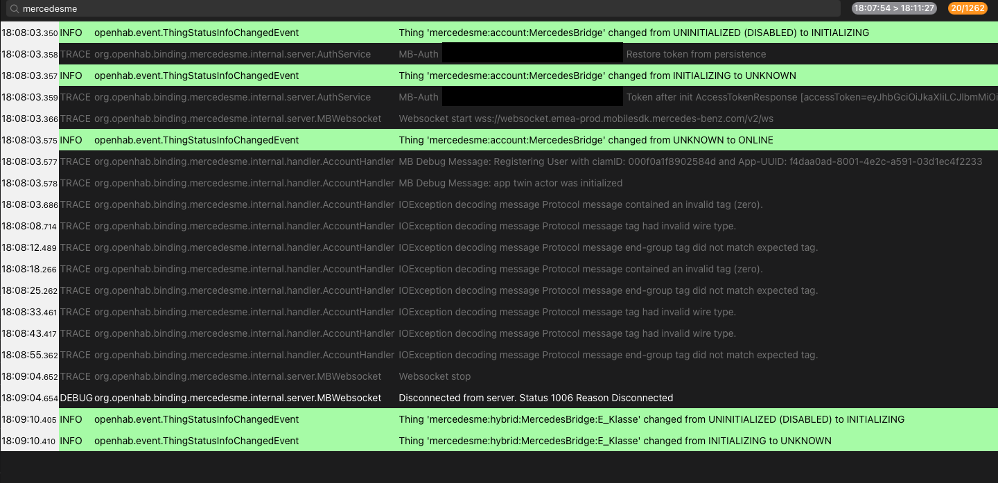

Dear Bernd, I have done so. Find attached the log file.
Thx for logs, much clearer now.
Technically it’s not a problem related to the new Auth method. Account / Bridge is ONLINE so this is working.
Vehilce stays UNKNOW because no data is received. This problem is reported 2 times e.g. from @OpenMarcus here. Sadly his vehicle causing this problem was taken offline by Mercedes so I wasn’t able to follow up this error.

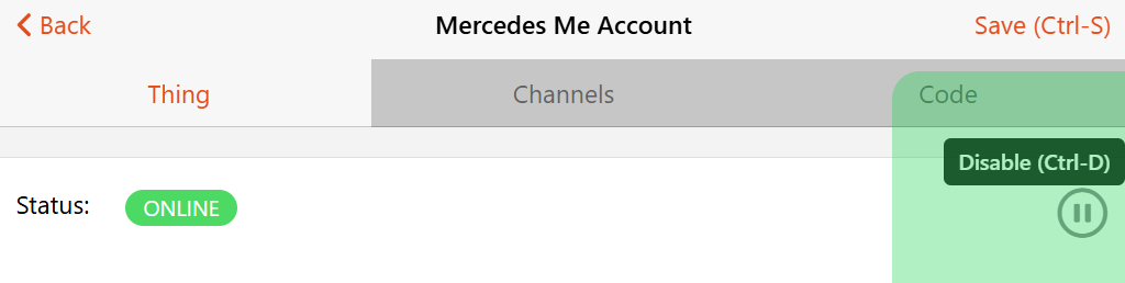

Hi, how do I ”disable” the account?
Pause button on the top right
