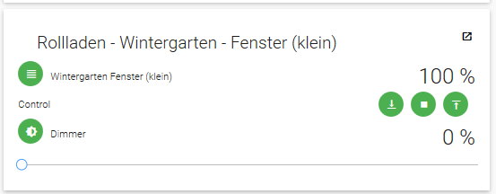

Dear all,
I just installed the new Version of openHAB 2.2 over my already well working openHAB 2.1 version. Migration worked perfectly. I was also lucky to see that the new version of openHAB recognized my “Merten (507801) Roller Shutter” correctly, which was not the case in the openHAB 2.1 The Roller Shutter device is online (green) and the name of the device appears correctly (this was not in openHAB2.1 the case). But never the less, even now as the device seems correctly be included in the system no channel appears and so no channel can be selected. All my other Merten things are working perfectly.
Can anybody help me with this issue. I would appeciacte very much.
Kind Regards
Jörg

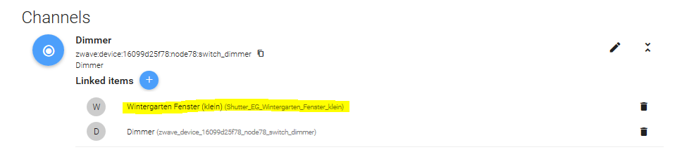

There are no channels defined in the database:
http://www.cd-jackson.com/index.php/zwave/zwave-device-database/zwave-device-list/devicesummary/617
You should look for your xml file and upload it to the db.

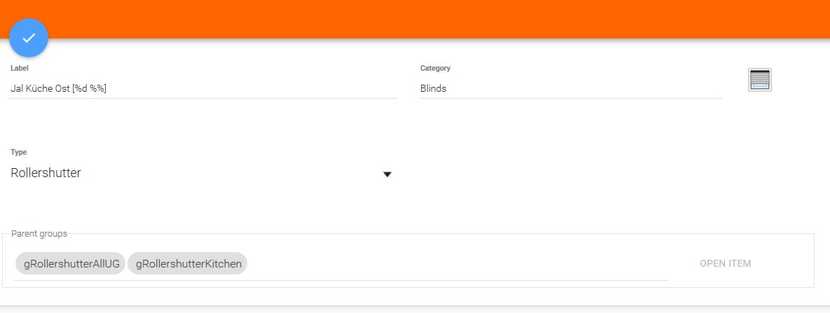

Just link the channel to a rollershutter item (Type=Rollershutter)
and for your sitemap use a switch:
2
Hello Sihui, thanks for your advice, this is what I allready did, the link is there the shutter appears correctly on the sitemap but nevertheless only the dimmer works but not the shutter
shutter_link_03
Sorry, no idea and can’t test because I don’t have any Merten devices.
I never tried to link two items to one channel, don’t know it that is the problem: remove the dimmer and see what happens.
I already did, but even then the shutter does not work. Thank you very much for your support.
