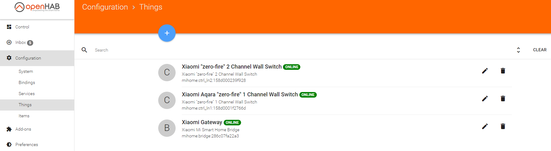

I can not get the events of pressing the buttons of the switches with the neutral line. I left for 2 weeks, or forgot or something has changed, help please.
There are 2 switches, one-key and two-key.
rules:
rule "x1"
    Channel "mihome:ctrl_ln1:158d0001f2766d:ch1" triggered SHORT_PRESSED
    logInfo("RULE","<-- x1")
rule "x2 ch1"
    Channel "mihome:ctrl_ln2:158d000239f928:ch1" triggered SHORT_PRESSED
    logInfo("RULE","<-- x2 ch1")
rule "x2 ch2"
    Channel "mihome:ctrl_ln2:158d000239f928:ch2" triggered SHORT_PRESSED
    logInfo("RULE","<-- x2 ch2")

switches work from site map and from paper, but the rules do not work, what do I do wrong?
Thank you!
PS openHAB 2.3.0 Build #1269
