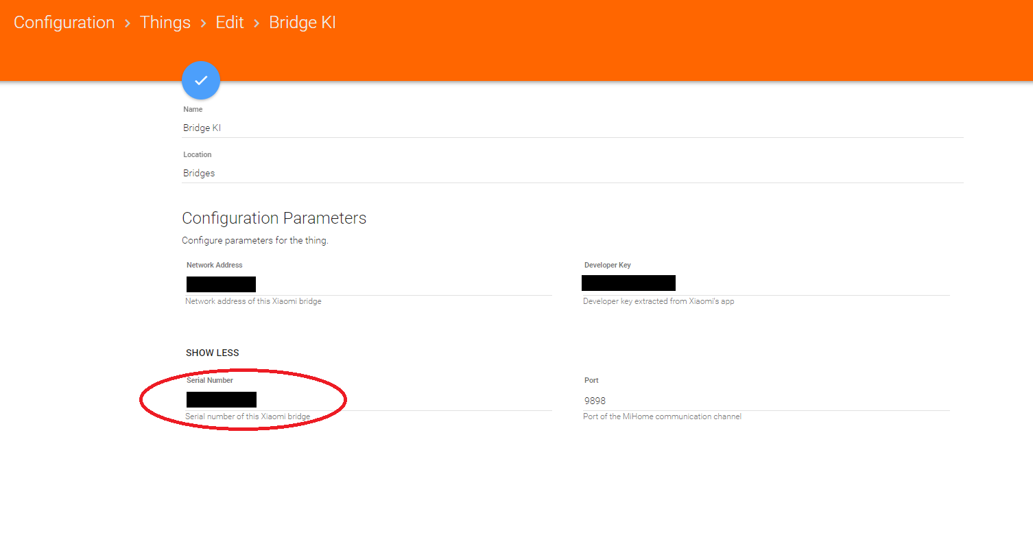

I don’t know if the previous posters that had a similar issue fixed theirs, but I had an issue recently with a new Xiaomi Gateway.
The first issue was that it refused to be autodetected by openHab. The only way I could get it onto OH was to manually add it using its IP. This is new. My previous two Gateways automatically were detected, and was easy to add. After updating to the newest OH, this seems to have become an issue. Not sure what the cause is.
After manuall adding, and entering the developer key, I did manage to successfully add the gateway, as well as the sensors attached to it.
BUT. I was unable to control the Gateway. I also received no updates from the sensors linked to it.
I could change the light on the Gateway with the Mi App, and basic things like Brightness would update on OH, but not vice versa.
I have two other of the same Gateways connected to OH, and they worked fine, so it was strange.
Now, I configure almost everything with files except for loading the actual Things which I do through Paper UI.
So, I took the three Gateways (2 working, 1 with the issue)'s JSONDB Things entries, and placed them together and checked for differences. And I found one. The non-working Gateway’s record didn’t have a ‘serialNumber’ field under properties.
The other two had an serialNumber, which is exactly the same as the identifier ID of the Thing. After some checking, I found that the serialNumber appears to be the MAC address of the Gateway, which is easily findable in the Mi App.
So, I entered the serialNumber (the MAC address without the colons) and refreshed the developer key, and reentered that. This resolved my issue instantly. I can now control my Gateway, as well as receive updates from the sensors connected to it.
So.
  • It appears when adding the Gateway Bridge manually via Paper UI, it doesn’t automatically assign a serialNumber Property to the Thing. This is a read-only field on Paper UI. I had to stop my OH service, and add the property manually to the JsonDB file, and restart OH, to add the value.
  • Note that this applies to the Bridge thing, not the Gateway Light and Sound thing.
Hopefully this helps someone.

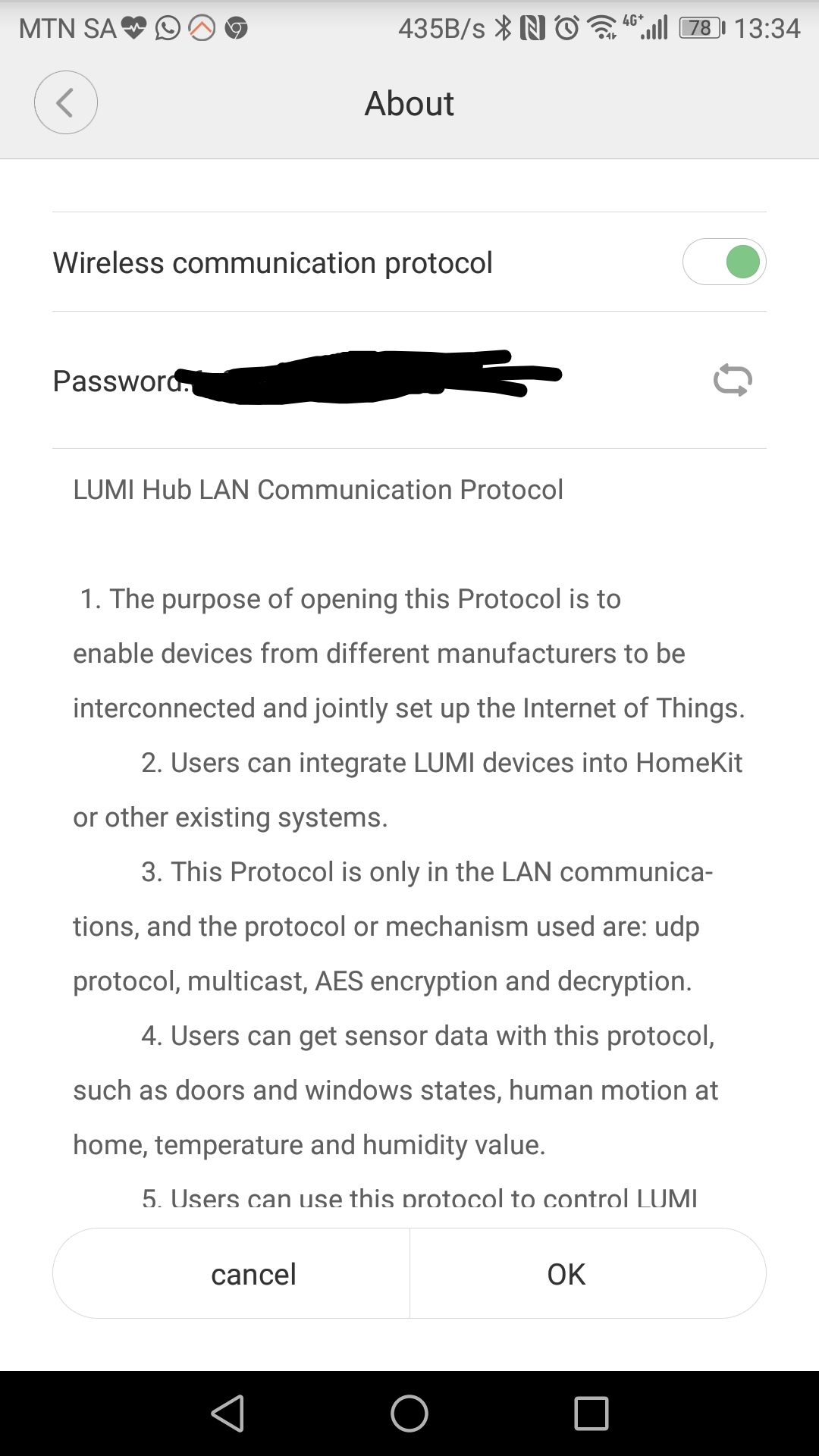

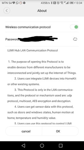

Hi there.
Does your ‘wireless communication’ menu screen look like this?
Generally in my experience, if the developer key isn’t correct, you are able to receive updates from sensors, but can’t actually send commands, so it seems to be the culprit. Also check for updates on your mi home binding.
Yes it looks same except on iOS it is all in Chinese - just in case I spun up an android emulator and got the same key (also tried new key button). Yes it feels like the key isn’t right as I get the same result if I type in any random string
I also can’t update the firmware on the gateway perhaps that is related to a hardware issue
Andrew
Okay, I see my iOS version of the APP also has the chinese on that screen. But I can see the same developer key that it shows on my Android version.
So the only other thing I can think of is that you have a similar issue to mine, where the serial might be missing. Or there might be input issues on your dev key.
See below, as per Paper UI:
Do you have anything entered under Serial Number as indicated on my screenshot?
Also check whether you might have spaces at the beginning or end of your Developer Key.
Also, is yours pointing to the same Port? 9898?
yes serial is mac address and yes 9898
