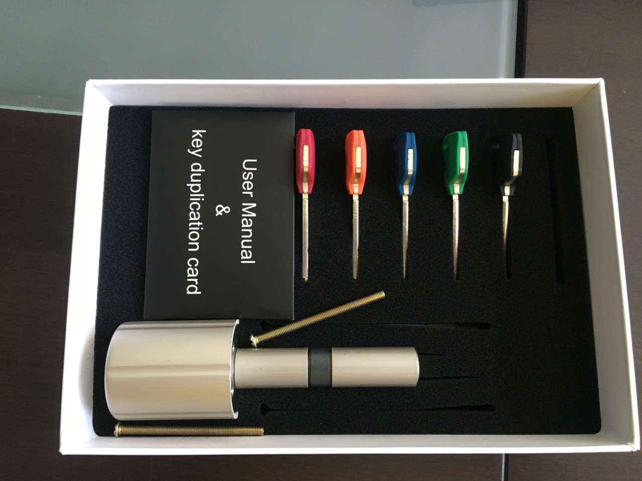

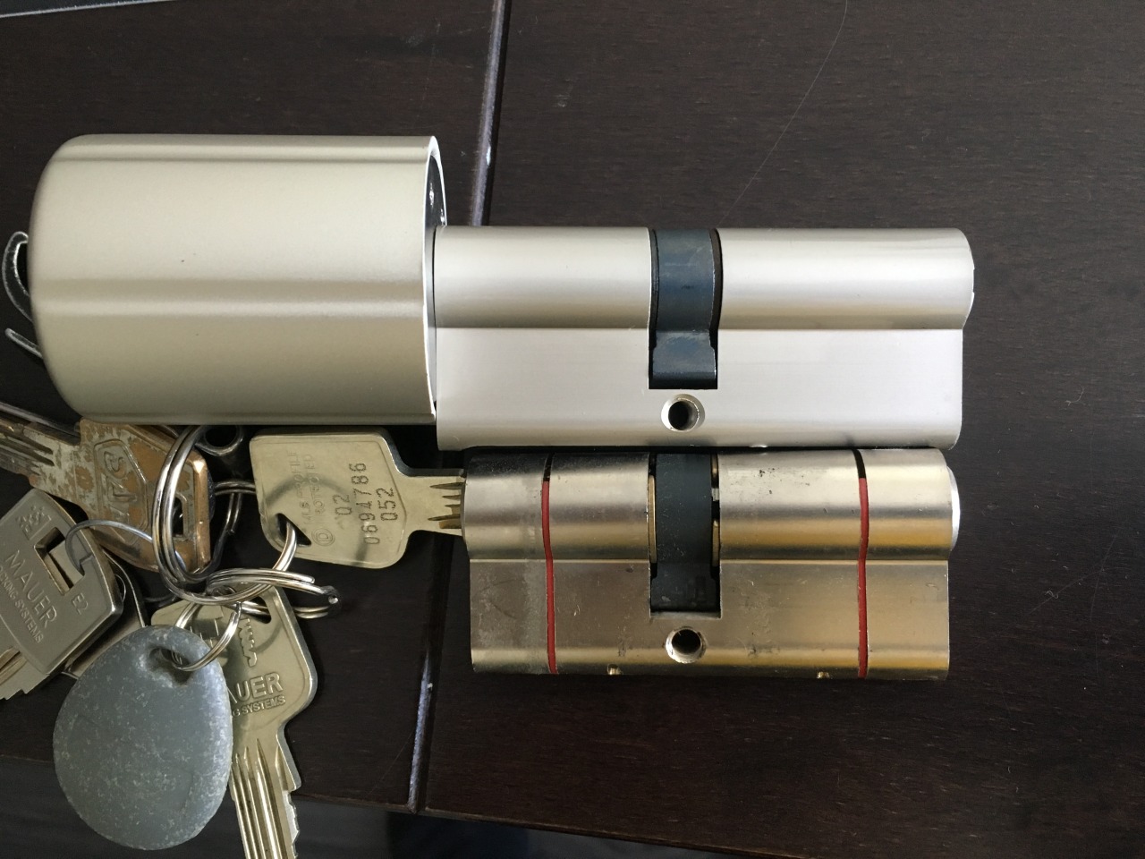

Hi Team here! Really great job! I already bought lot of Xiaomi smart stuff and also successfully bind it into OH - temperature, humidity sensors, Air Index sensor, el. plug, IR remote, door sensors, Roborock .. but this time I tried door core lock which is not integrated in OH Mi Smart binding. This lock can give information which from registered keys is used to unlock, reminds for not pulled out key after unlocking and most important - can give alert when there is illegal try for unlocking. Integration in OH can give chance to disarm alarm system with unlocking the door with registered key and so on. It works through Gateway. I’ve been able to extract token from iOS sqlite database from MI Home App. I can support (with a little help) if someone capable of integration of it wills to do it (can try to capture its communication to the gateway with Wireshark etc). Please excuse me if this is not the right way for requesting it - still not very aware hot he community works here.
Here are few pictures of this Wima Door Smart Lock.
Thanks everybody for their time and efforts making this binding better and better!
