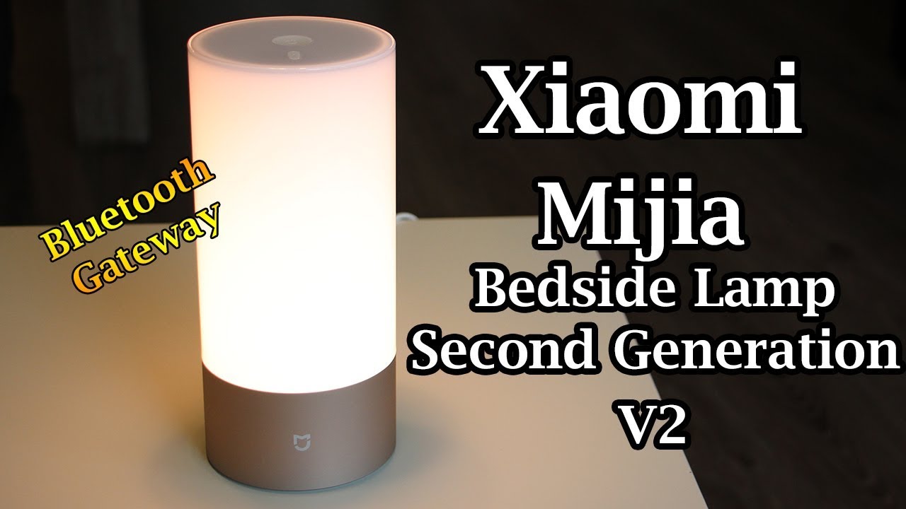

upon gearbest shopping i stumbled over the Xiaomi Thermostat Accuracy Temperature Humidity Monitor:
https://www.gearbest.com/robot-vacuum-accessories/pp_1306883.html
It seems to be basically the temperature sensor with a LCD display for displaying current temperature and humidity.
Does someone have some experience with it already? Is it supported by the binding?
Regards
Simon
You need this lamp as bluetooth gateway:
The mi home gateway is only zigbee, no bluetooth.
