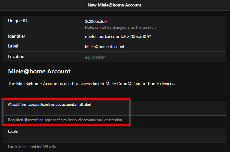

I use the binding for the first time. I have a Miele account since I bought a Miele coffee maker CM6360 with cloud connection.
Unfortunately I don’t understand, what I have to write into the field “@text/thing-type.config.mielecloud.account.email.label” of the bridge! The e-mail address from my Miele account don’t work.
It would be great, if someone can help me!
Hi @henryd! The documentation has exhaustive examples of how to configure the account. If you follow the instructions then you won’t have to manually populate the field. Please read and follow the instructions from the sections Discovery and Account Configuration Example from the documentation and report back if you encounter a problem.
Hi Björn,
Many thanks for your quick response! Now it works fine :smiley:!

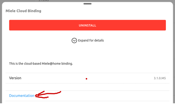

I didn’t found the binding documentation via the link of the installed binding - its dead.
