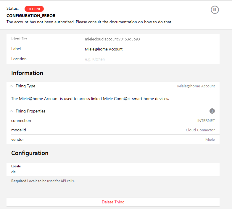

Hello all.
I am using OH3.0 and wanted to use the binding.Could somebody describe how to create a thing and where to add the Client ID and Client Secret?
Rencent thing looks like this:
UID: mielecloud:account:70153d5b93
label: Miele@home Account
thingTypeUID: mielecloud:account
configuration:
  locale: de
In the UI I am not able to enter any details:
Using binding version beta5
Hi @shuo, please take a look at the documentation. Everything you need to know is described there. Especially the sections Discovery and Account Configuration Example should help you.
