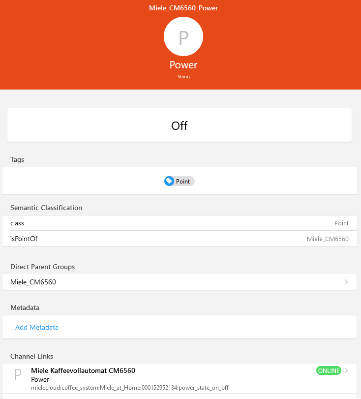

as already mentioned the binding is working fine at my installation. Only thing i am wondering is, that the power state is defined as a string, wouldnt it make more sense to define it as a switch?
When i change the item to a switch, i get the following error in the logs:
19:39:36.736 [ERROR] [org.openhab.core.items.GenericItem   ] - Tried to set invalid state 1.0 (DecimalType) on item Miele_CM6560_Power of type StringItem, ignoring it
Hi @e36Alex, we discussed this during development and decided to use String rather than Switch because we wanted to be consistent with program_start_stop_pause and program_start_stop. If you want a Switch you can easily simulate it with a custom item and some rules.
Thank you for the explaination.
I added a switch item with a map-profile and it seems to work.
