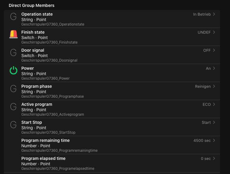

i noticed a little issue in the binding for a dishwasher G7360:
The elapsed time is not increasing/updating.
Currently the dishwasher is running but elapsedtime stays on 0 sec:
I tried to add a new item, but same result.

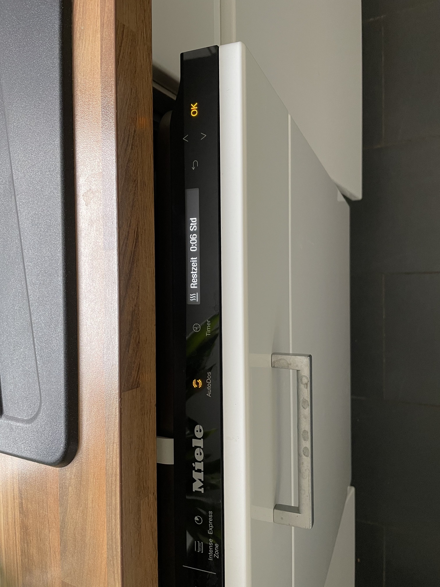

No I think you misunderstood my edit. Its just to confirm, that elapsed time is updating with the wasching machine, but not with the dishwasher. For the whole 2.5h running time, the elapsed time was still “0 sec”. Maybe it is a model without this information? Because the display is just visible when the program is almost done and the door is opening a little bit to support the drying process.
So when I found out to open an issue, I will dot it :slight_smile:
PS:
Elapsed time still “0 sec”:
