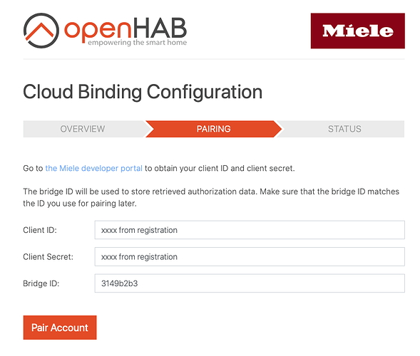

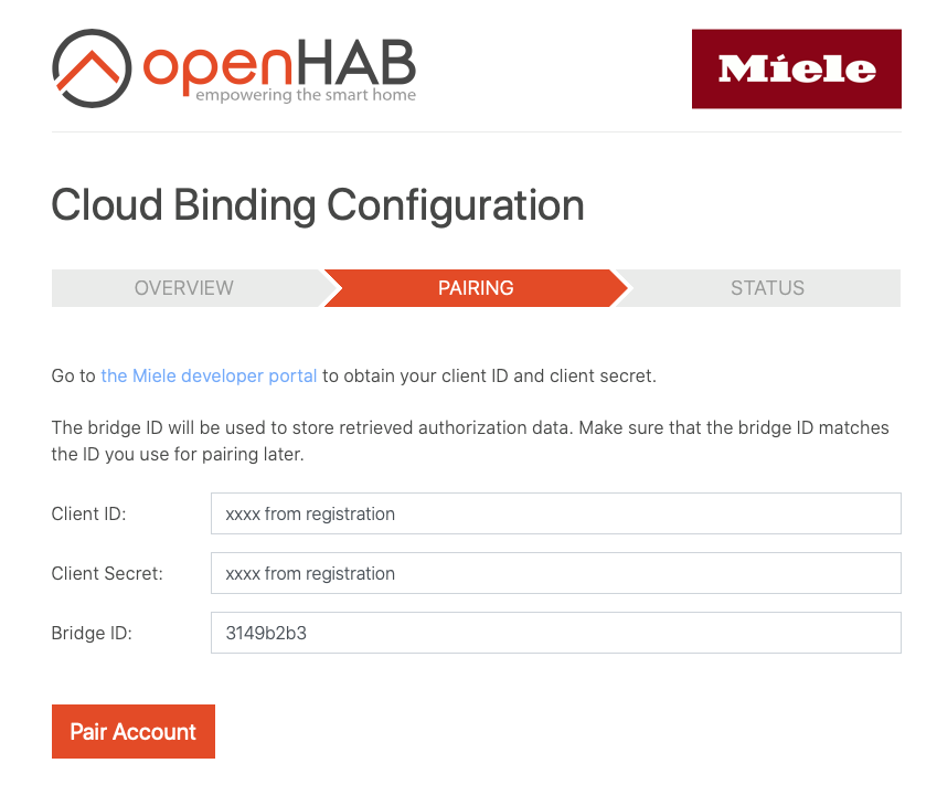

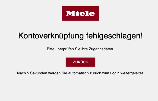

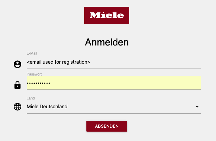

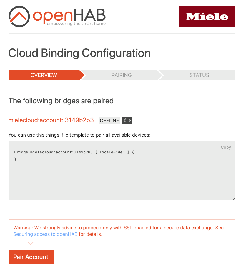

I’m still struggeling with the setup.
  • The binding jar was copied to the addons folder and shows up under bundle:list
  • I added a thing for an Overn, locale=de
  • I launched 127.0.0.1:8080/mielecloud entered clientid and secret
  • I used the last 8 digits of the bridge Id and “Miele Deutschland”
  • I’m entering the same credentials as I used in the App
  • and get a “Kontoverknüpfung fehlgeschlagen” (unable to link account)
I already tried to change my password, so I’m sure I use the correct credentials. I also tried to remove the + sign from my password (requires URL encoding), but also doesn’t work. I enabled DEBUG on the OH console “log:set DEBUG org.openhab.binding.mielecloud”, but see no output in log:tail.
Any idea?

maybe I’m dumb, but that’s my situation
Bildschirmfoto 2021-01-10 um 19.47.59
Bildschirmfoto 2021-01-10 um 19.49.35
Bildschirmfoto 2021-01-10 um 19.52.04
Bildschirmfoto 2021-01-10 um 19.52.12

Sad to hear that and sorry for the inconvenience, it should work out of the box. The binding version should also have no effect on this.
There aren’t any logs because authentication with the Miele Cloud service is performed externally via OAuth2 in the Miele cloud, this is comparable to “Log in with Google/Facebook/etc.”.
Thus the binding does not know your credentials and has nothing to do with whatever needs to happen in the Miele cloud to make things work. This also means that the binding doesn’t know that the authentication failed.
I had this problem once during testing. It was caused by a temporary outage in the Miele cloud so I suggest to try again later. I will make Miele aware of this problem and hope they fix it soon.
  • I already tried 15 times with delays in between (e.g. yesterday evening, this morning)
  • I recreated the thing, rebooted OH
  • Changed my password multiple times in the iOS App, also making sure having the correct credentials for the pairing
all of that doesn’t fix the problem.
