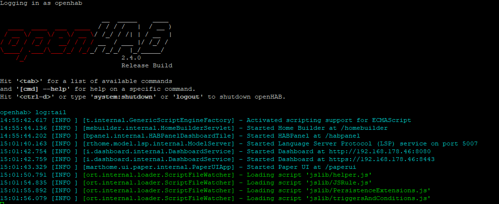

First of all you should log into the openHAB console and start a log tail (or use the log viewer), to get all relevant log messages.
jsrjsTut_start_oh_cli_console
After that you have to download lewies library and copy the contents to th automation\jsr223 folder like shown in the image below.
jsrjsTut_install_lew_js_lib
If you are not seeing any messages/errors you may need to reload the scripts/automation bundle.
I have simply restarted the whole openHAB service and got the following outpout in the console afterwards:
As you can see, everything loaded without throwing errors.

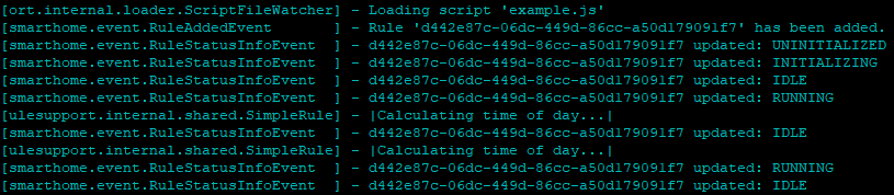

It should look like this in your console:
Still no errors.

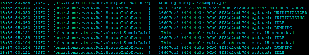

When you save example.js now, the log should be a bit different:
You can see that theres something wrong on line 158 of the triggersAndConditions.js file of the library.
If you open the file you will find the following function at that line:
var getTrName = function(trn){
	return trn == undefined || trn == null || trn == "" ? uuid.randomUUID() + "-" + me.replace(/[^\w]/g, "-") : trn;
	//return trn == undefined || trn == null || trn == "" ? uuid.randomUUID() : trn;
delete the first return statement and uncomment the second one, which should solve this problem for now.
If you save the example.jsfile now, the rule should run and log the message every 15 seconds.

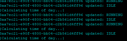

Check, if the test setup works with saving the example.js file.
It should look like this:
Fine.

Your log should display no errors and run the rule every 15 seconds:
Time for some calculation.

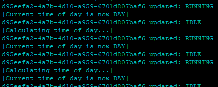

Let’s save and check the logs again.
I have added some logging already which should output the current time of day,
according to our calculation.
Depending on the time of day, when you are doing this you should get some result for the calculation.
For me it’s DAY while im writing this thread.

Simple as that.
We check, if the current item state is different from our calculation and update the item if that’s the case.
Should look like this in your logs:
