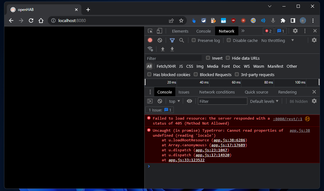

Grrrrr. I tried to manually edit the .bat to see if I could comment out the unzipping part (since I’d already manually done this) but I only spent a few minutes attempting to look through the restore batch file (and the other restore scripts/powershell scripts it apparently calls) before I gave up. Ok fine, I’ll just start from scratch then, not the end of the world… except now I can no longer load the main OH web interface after logging in to an administrator account - there’s nothing but a black screen. I tried different browsers, tried clearing my browser cache, rebooted, have no idea how to run an “openhab-cli clean-cache”. I did find online a suggestion to run the command “openhab:users clearSessions ” which did complete successfully but I still am just faced with a black screen. Inspecting this black screen with my browser’s developer tools shows the following errors:
Failed to load resource: the server responded with a status of 405 (Method Not Allowed)
app.js:38
Uncaught (in promise) TypeError: Cannot read properties of undefined (reading 'locale')
    at u.loadRootResource (app.js:38:6286)
    at Array.<anonymous> (app.js:17:17689)
    at u.dispatch (app.js:23:1047)
    at u.dispatch (app.js:17:14920)
    at app.js:33:123522
I guess at this point I’ll just uninstall everything and start again, skipping attempting to restore from a backup. I just wanted to ask is it at all possible to restore from a backup .zip when migrating from a Linux to Windows openHAB installation? I realize that there might be some issues with regard to filepaths and so I was going to use Visual Studio Code to open the unzipped backup .zip folder and try my best to “find and replace… in files” any references to Linux file paths and then hopefully could re-zip the folder and try again from there? Probably still just best to start fresh?
