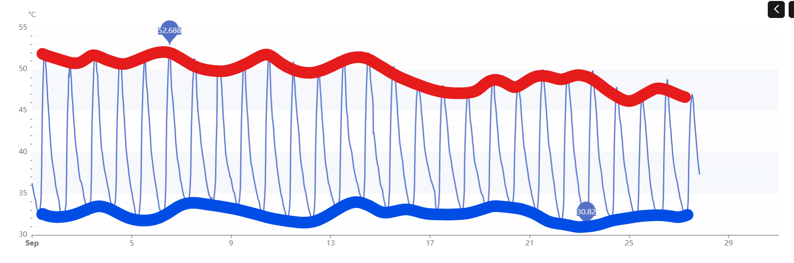

thats what I was hoping for.. but it still gives me the ranges (going up and down) rather than pure min/max values per day.. see below example - essentially i want the big red and big blue lines.. not the thin blue line
Can you colour it white, or give it zero thickness?
as far as I understand the thick red and blue lines were manually added in the taken screenshot; they are wanted but not yet shown in the original graph ( see there are some peaks that are higher than the red line ).
I think you only added the lables for min and max value. Not the min resp. the max curve.
Just did some experiments the first but. I have the impression that you only can have on or the other ( min or max curve but not both. At least I was not able to get both of them.
