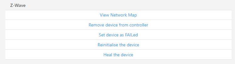

As a battery device this may be true or not. Do you have 5 lines on the UI page? If not wake the device untill you do. At that point somewhere on your system will be a OH generated XML to use as @anon71759204 directs.

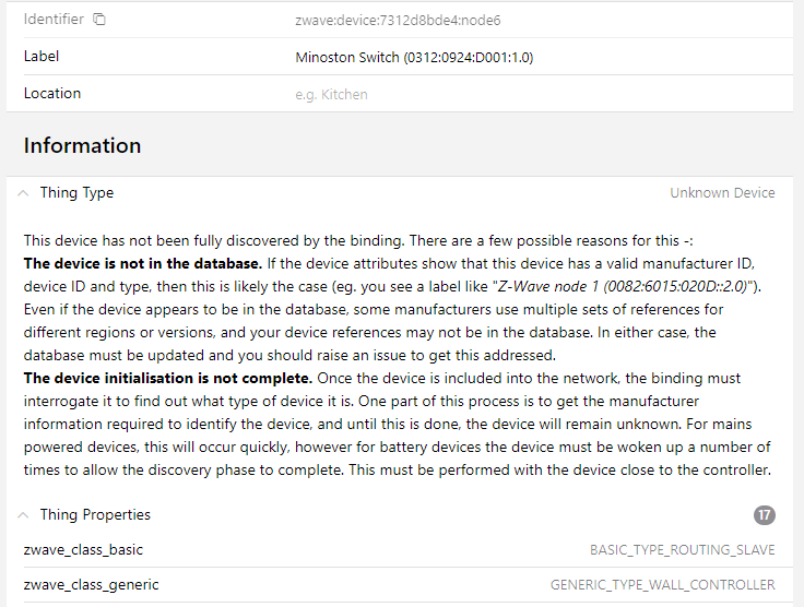

OK. I managed to get it excluded and re-included, but here’s what it shows when I add a Thing. I have woken it up several times, FWIW. If the MR40Z is in the database, is there something I need to do on the openHAB side?
From the openhab log, this might help. NODE6 is the new device:

2022-12-03 09:31:54.829 [WARN ] [wave.discovery.ZWaveDiscoveryService] - NODE 6: Device discovery could not resolve to a thingType! 0312:0924:D001::1.0
2022-12-03 09:31:54.834 [INFO ] [g.discovery.internal.PersistentInbox] - Added new thing ‘zwave:device:7312d8bde4:node6’ to inbox.
2022-12-03 09:31:55.089 [INFO ] [ommandclass.ZWaveVersionCommandClass] - NODE 6: Command Class COMMAND_CLASS_BASIC has version 0!

@apella12 yes, I do see these lines in the UI:
Ok that is good.
Also try to put logs in the </> they are easier to read. I can see some issues, but they are unrelated to Node6.
What is the problem is that the device was added in September and OH3.3 is from June. Your numbers match so it will be recognized (nothing to add to the DB). Look at the bottom of this post for two ways to update your binding and device. Choose the one you feel comfortable with.

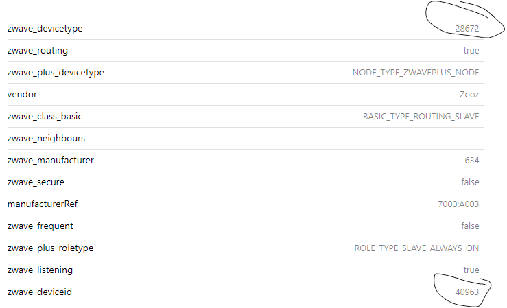

Regardless I think it is likely you may have a new TYPE:ID from the device in the binding. Note the UI have decimal numbers and the ZW DB are hexidecimal.
To check this look on the UI thing properties for type ID and Compare to the ZW DB.
