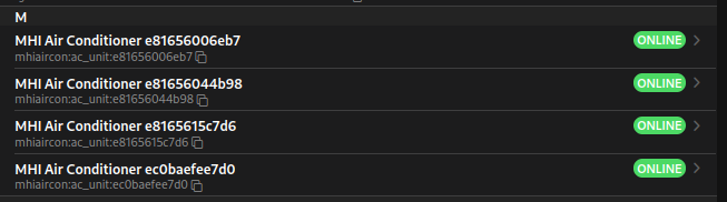

Is nagios something that can be leveraged? Those 4 IPs are my MHI AC units with RAC-WF modules. I have the Home Assistant code (using python zeroconf for discovery) and I’m working in that direction as well.
$ nmap -sV 192.168.1.0/24 -p 51443
Starting Nmap 7.93 ( https://nmap.org ) at 2024-03-22 20:24 CET
Nmap scan report for _gateway (192.168.1.2)
Host is up (0.0040s latency).
Nmap scan report for 192.168.1.110
Host is up (0.053s latency).
PORT      STATE SERVICE     VERSION
51443/tcp open  nagios-nsca Nagios NSCA
Nmap scan report for 192.168.1.111
Host is up (0.079s latency).
Nmap scan report for 192.168.1.112
Host is up (0.014s latency).
Nmap scan report for 192.168.1.113
Host is up (0.048s latency).
Service detection performed. Please report any incorrect results at https://nmap.org/submit/ .
Nmap done: 256 IP addresses (18 hosts up) scanned in 17.41 seconds

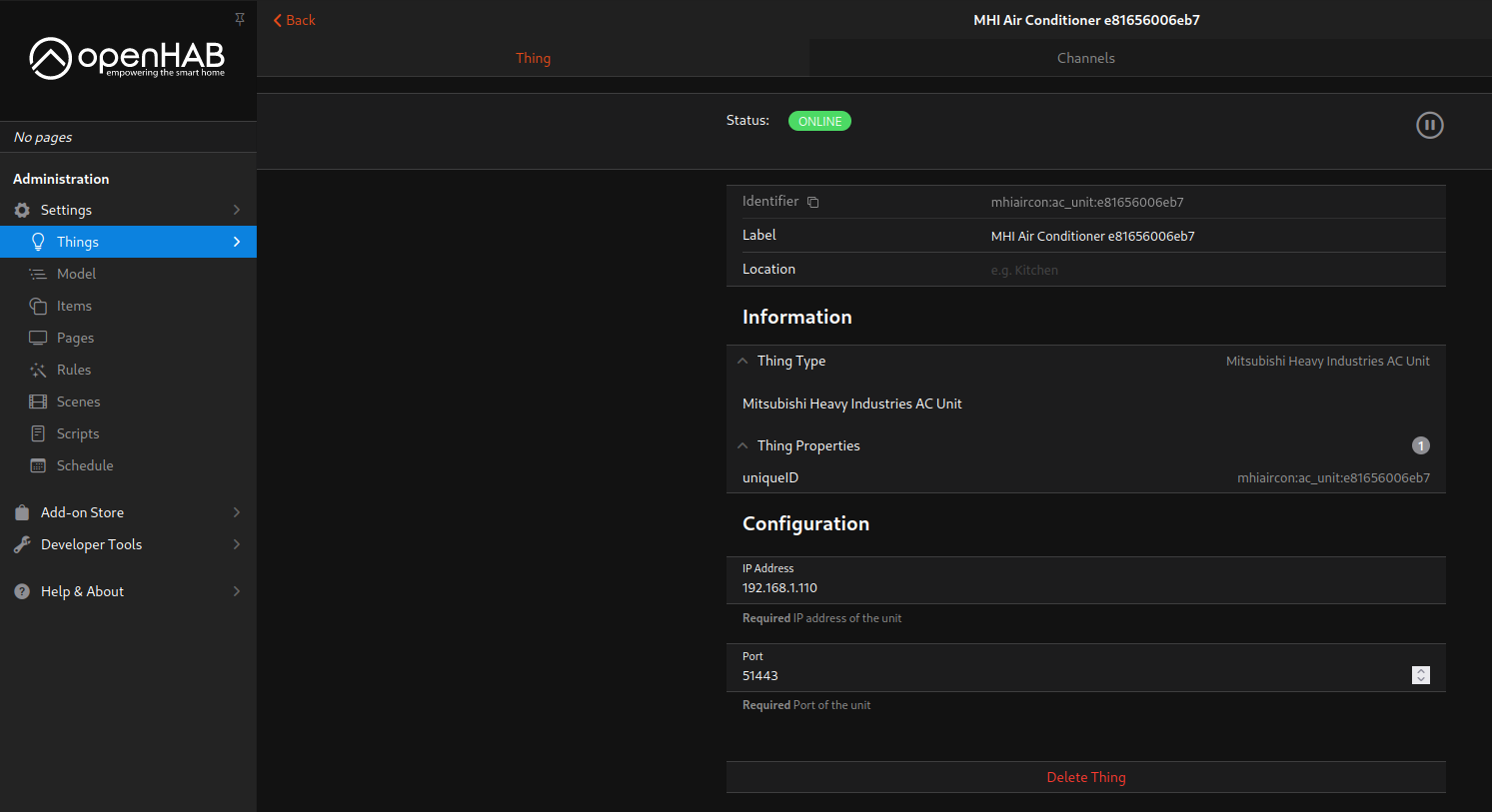

I have discovery working for the RAC-WF :heart_eyes: Thanks for all heavy work done by authors of other bindings, obviously! All I had to do was put together a binding skeleton, copy over Daikin binding (and modify the naming, trim some stuff) and copy over the zeroconf discovery from MPD binding.
I’d appreciate help with naming - are there any rules I should stick to? I tried to use the best guess so the binding name is mhiaircon, but should it be just the brand name? Without the aircon part?

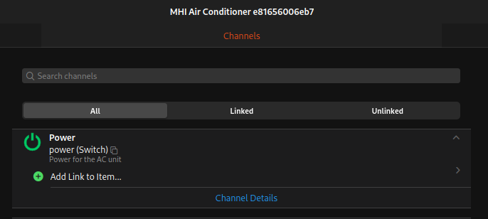

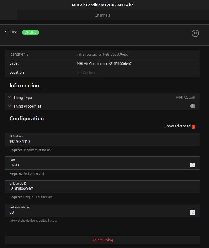

Status:
  1. Discovery works (better than in the Mitsubishi android app :smiley: )
  2. Some limited communication with units, with parsing of the responses into a java structure
  3. HA python parser converted to standalone code + some response string examples
  4. No real information exchange yet, fake online status set
  5. Bunch of parameters in the config
  6. Half-set power channel
    The next step - convert the standalone HA parser code into java and use the values to get real unit stats.
  7. The code is still unworkable for other developers (really messy) as I’m still trimming the Daikin parts and learning how openhab works.

Read only mode: power, preset temp, indoor and outdoor temperatures work
15:50:04.575 [TRACE] [ng.mhiaircon.internal.api.ControlInfo] - info.power: false
15:50:04.578 [TRACE] [ng.mhiaircon.internal.api.ControlInfo] - info.presetTemp: Optional[26.0]
15:50:04.581 [TRACE] [ng.mhiaircon.internal.api.ControlInfo] - info.outdoorTemp: Optional[31.2]
15:50:04.584 [TRACE] [ng.mhiaircon.internal.api.ControlInfo] - info.indoorTemp: Optional[28.7]
