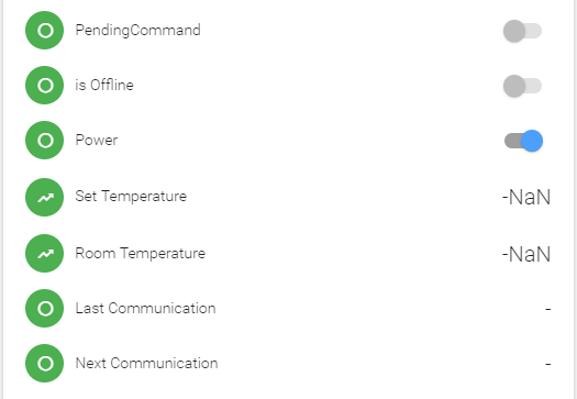

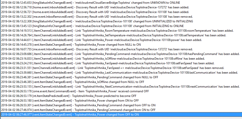

First thank you for creating the binding. I was waiting for a long time :slight_smile:
Anyway I installed the binding. I have two ecodan heat pumps. One local and one as guest access.
Observations:
  • It instantly finds only 1st device in melcloud app(happens to be guest access pump). I removed guest access and I see only local heat pump now. (Needed to restart binding).
  • Added the Thing and created Items shown below
Event Log - from binding to trying to power Off as Power is only operation available:
OpenHab log - repeting every minute:
If you need any other help/info would be glad to help.
br,
Dusan
Hi !
It’s so difficult troubleshooting with so few informations…
The best option should be to have access to your melcloud and debug the messages.
Otherwise start openhab in debug mode (or lower the log level in debug mode the binding ) and send me it.
Let me know.!
Luca
