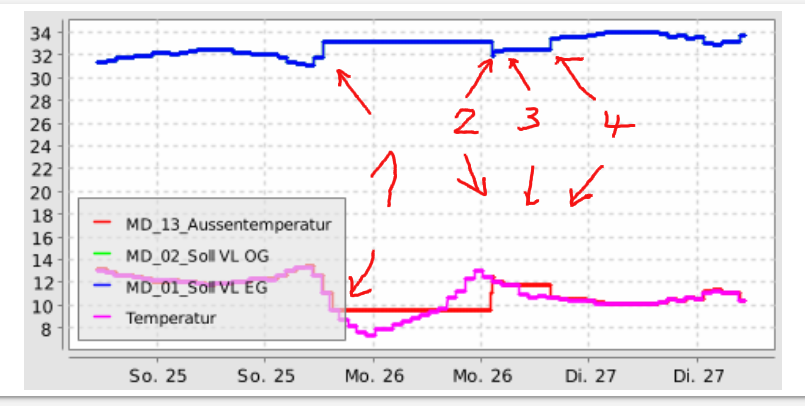

I get the current outside temperature from a weather service. I send this to the WAGO every 15 minutes. This recalculates the target temperatures of the water for the heating circuits in the WAGO. I read these values back out of the wago for display purposes.
In the event of a failure, the outside temperature is no longer taken over, and the target temperatures are also no longer reported back.
I had such an incident the last few days (see picture).
  1. first failure
  2. restart of the modbus binding via karaf console,
  3. shortly afterwards, the values froze again.
  4. reboot of the pi
blue (covering green): calculated target temperatures (Thing data md_soll_vl_eg / md_soll_vl_og)
pink : outside temperature (from weather service)
red : temperature of the modbus channel to the Wago (Thing data md_aussentemp)
chart

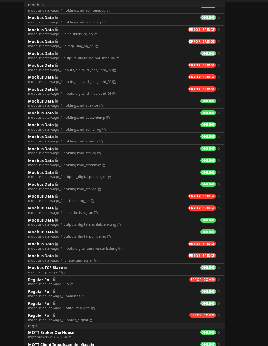

At next incident, use the Admin part of your GUI to see what state Modbus Things are in.
Every Modbus data Thing has timestamping channels.
You might learn something by temporarily linking say the lastWriteError channel of one of your write thing, and the lastReadError channel of one of your sleepy read things. Link these to DateTime type Items - changes will be visible in your events.log even if you don’t put them in your UI.
Also, the lastReadSuccess channel of a suspect read thing. Taken together, you will see errors or simply polling stopped.
I’ve never seen any instance of the binding “losing” a poller; but stuff just stopping has been a symptom of general performance bottlenecks, which may occur anywhere in your system.
Let’s see if you get actual errors first.

It has occurred again. I have made a screenshot of the affected items:
modbus_fail
I then replaced the name in the rules file with the IP address.
ridge modbus:tcp:wago_1 [ host="192.168.178.201", port=502, id=1, connectMaxTries=3, reconnectAfterMillis=600000, timeBetweenReconnectMillis=100]
    Bridge poller io [ start=12288, length=5, type="coil", refresh=5000 ]
Since I changed the rules.file, the items no longer have any errors. However, the temperature in the Wago is still not updated.
I connected to the Wago with CoDeSys and the temperature from this morning is still entered there (14.2°C). I tried to set the temperature to 17°C first and then to 15.4°C (current temperature) using a manipulated rule. The value of the channel is changed, but no information arrives at the Wago.
(I have also observed this behaviour before: At first the sending still seems to work - but in fact the information no longer arrives at the target system. If the system is then left to run for some time, the send channel also remains at the old value.)
