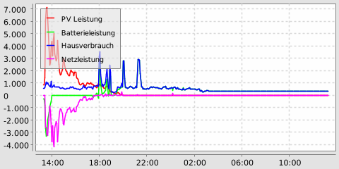

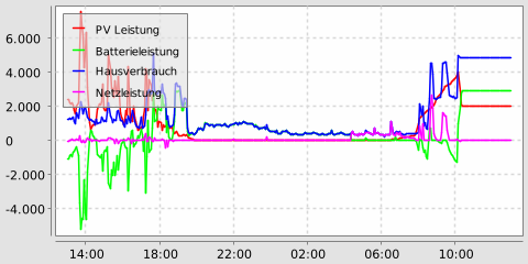

You see the modbus stopping in the Chart 1 today, after I updated to 2.5.8 yesterday.

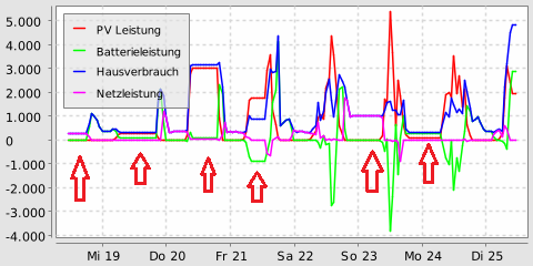

Chart 2 shows the stops of the last week. I restarted the service ore did some changes trying to fix it and restated openhab, after that it stopped again.

And the chart doesn’t quite show a lot details, all the Wattage values stay the same as the things are not updating.

I’ve got no obvious errors as far as I can see.But the test shows that the problem only occours whith the small polling period. Does the Modbus binding have any maxium polling rate?
Maybe it has more to do with the update to the linux strech release and some changes theat come with it.
