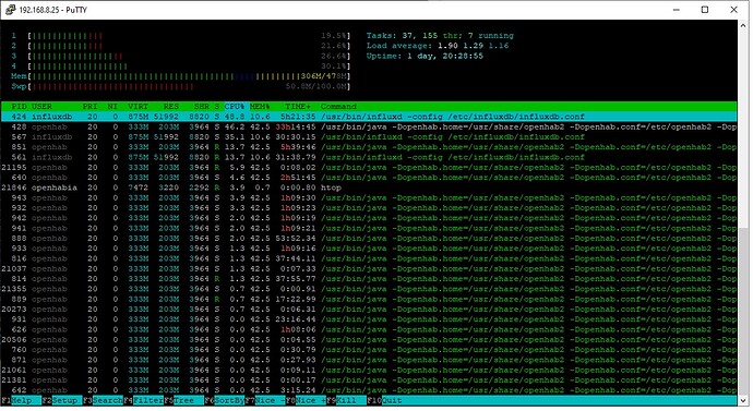

The system usually crashes within a few hours of the first errors being logged.
Following is system setup and present memory ..

I second everything Rossko57 says and I have to ask what makes you think it’s a memory leak?
Updates = 56 apt updates available.
Looks like your system needs to be updated and also OH itself has a newer stable version available.

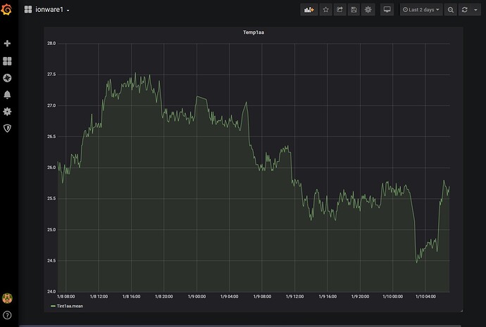

Thanks for getting back.
As I said previously, I have a number of configurations running to identify the issue. The following is a setup as follows;
rpi3A running OH2.4 192.168.8.8 ip .. with our modbus server slave software also running on same rpi3A using the local ip 127.0.0.1:8180 socket to communicate.
It is now getting errors after approx 20+ hours ..
2020-01-10 05:32:55.986 [vent.ItemStateChangedEvent] - Tint1aa changed from 24.899999618530273 to 24.600000381469727
2020-01-10 05:33:46.198 [vent.ItemStateChangedEvent] - Tint1aa changed from 24.600000381469727 to 24.700000762939453

Did a htop as follows .. and note the swap memory is maxed out ..
I see you´re using influx as well as grafana.. Are you using grafana image rendering? If so, how?
I had a very bad experience with OH crashing (well, it was actually Java crashing) causing OH to restart when I was running OH 2.4 with influx and grafana rendering images uisng phantomJS..
I ended up moving Grafana to another server (Windows).
Perhaps try temporary stop Grafana, just to see if it makes any changes.
Yea .. I was wondering whether Grafana/Influx might be an issue and that was going to be one of my next steps .. to take it out of the equation.
But I do like the pretty graphs. :slightly_smiling_face:
You can still have your graphs.. Just move Grafana to another server..
I just noticed you´re using an Rpi3A (I didnt even know there was an A model). I´m using a Rpi3B+ on my main system. Thats the same Rpi which had the major issue running OH 2.4 with Grafana rendering images using phantomJS.
So if you´re using a Rpi3A, I would say for sure you are pushing it way above its limits.. But give it a try by stopping grafana first (no need to stop Influxdb.. It hardly uses any resources).
There may be another option regarding image rendering of Grafana.. They dumped the phnatomJS and made something new. There should be a tutorial here somwhere.. I have not tried myself, cause I choose to move Grafana insted, already having a windows server running doing nothing :smiley:
Now theres a bunch of reasons why your system crashes. RPi is getting a bit lightweight.

OK .. one of our setups is as follows ..
  1. rpi3A running OH2.4 .. c/w Grafana/Influx .. ip xxx.25 Modbus 2.x TCP Master wifi to ..
  2. rpi0 running our modbus software server slave ip xxx.120 (no OH2) ..
This setup has been running with no errors for 40+hrs ..
htop as follows ..
Note swap mem ~50% ..
Me thinks the problem lies with running oh2.4 and our modbus system together on one rpi3A using the 127.0.0.1 ip.
Perhaps its just too much for the rpi3A setup ..
Will remove Grafana as Kim advises and see how that goes :thinking:
This won’t make it better, possibly worse. Properly set up Modbus error recovery adds delay to any remaining working parts of your modbus system, extending transaction queues.
If want to think about this properly, please see guide -
But in truth with one Modbus slave as you have shown us, I would leave retry settings at default
Messing with this will not fix your problem.
Get rid of modbus.cfg. It’s neither use nor ornament. Make very sure that you do not have v1 binding installed alongside v2.
Okay, so you have one slave, a half dozen pollers at fairly high poll rates, and many tens of Item? I am guessing all those data Things are linked to Items?
This is asking a lot of an RPi3. It’s not too much at all - but there are big performance traps set for you. (Especially if you are running your slave on the same RPi). There is not enough performance to allow you to be careless here.
Modbus binding defaults are suited for unfamiliar users to get a simple project going, you’ve moved beyond that and should take steps to tune your system.. All those Items updating every half second is stressing out the rest of your system - are some/all persisted?
I recommend to read and implement here -
Reviewing the performance guide, I feel should add a additional section about TCP behaviour. Again, the defaults get you started but need proper consideration in a limited resource environment - which can include the target Modbus slaves, not just the openHAB host.
This is probably the cause of your logged TCP errors, but has likely nothing at all to do with system issues.
I’ll add this when I’ve thought about it, but you’ve got plenty to get on with and I think that is more relevant.
And yes, v2 binding has different potential stress points and different settings to deal with them … because it’s different.
