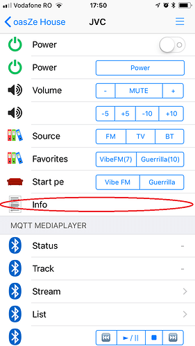

Still something else is wrong with that example. Look what i get:
with this: String Info “Info [XPATH([name()=‘liveStreams’]/[name()=‘stream’]/[name()=‘label’]/) %s]” {http=“<[http://campulverde.info/liveStreams.xml]”}
you have to give a closer look :wink:
there is something missing " : "
azimuth’]/):%s °C]
I added “:”. Still no difference then the last print screen :frowning:

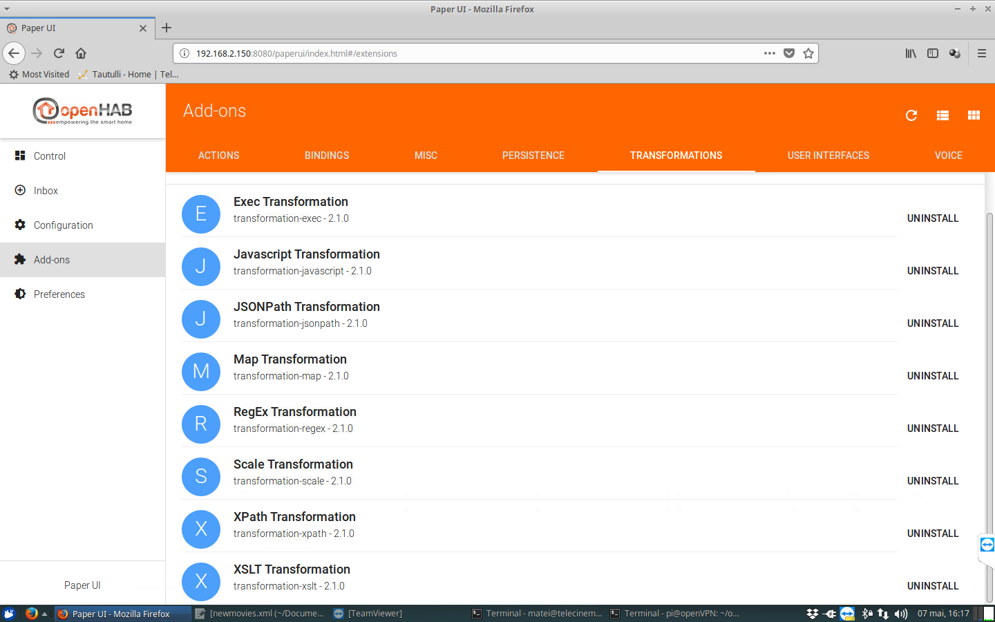

But you have installed the XPATH transformation!
What does the log say?
@gsmatei this works
String http_Info "Info [%s]" {http="<[http://campulverde.info/liveStreams.xml:60000:XPATH(/*[name()='liveStreams']/*[name()='stream']/*[name()='label'])]"}
Looks like it’s installed.
