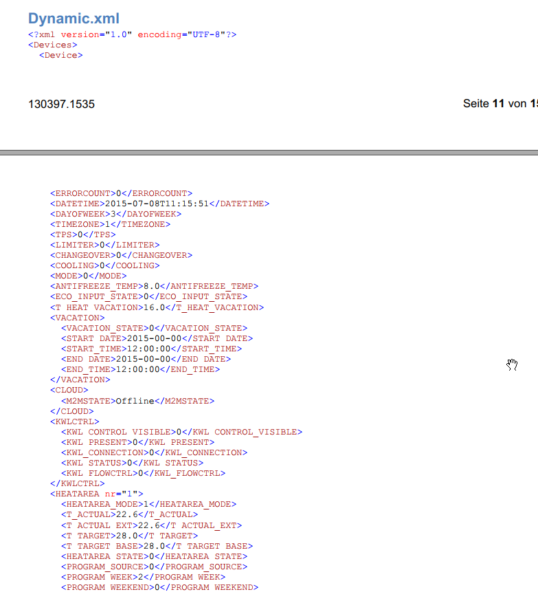

I have this XML File from the Heating unit

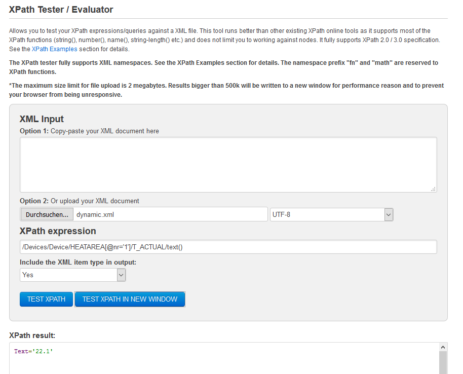

If you copy paste the XML in a code fence then we could actually try to write a working path for you using a online validator like https://www.freeformatter.com/xpath-tester.html

Hi here my XML.
<Devices><Device><ERRORCOUNT>0</ERRORCOUNT><DATETIME>2018-03-28T19:46:53</DATETIME><DAYOFWEEK>3</DAYOFWEEK><TIMEZONE>1</TIMEZONE><TPS>0</TPS><LIMITER>0</LIMITER><CHANGEOVER>0</CHANGEOVER><COOLING>0</COOLING><MODE>0</MODE><ANTIFREEZE_TEMP>8.0</ANTIFREEZE_TEMP><ECO_INPUT_STATE>0</ECO_INPUT_STATE><T_HEAT_VACATION>16.0</T_HEAT_VACATION><VACATION><VACATION_STATE>0</VACATION_STATE><START_DATE>2018-00-00</START_DATE><START_TIME>12:00:00</START_TIME><END_DATE>2018-00-00</END_DATE><END_TIME>12:00:00</END_TIME></VACATION><CLOUD><M2MSTATE>Online</M2MSTATE></CLOUD><KWLCTRL><KWL_CONTROL_VISIBLE>0</KWL_CONTROL_VISIBLE><KWL_PRESENT>0</KWL_PRESENT><KWL_CONNECTION>0</KWL_CONNECTION><KWL_STATUS>0</KWL_STATUS><KWL_FLOWCTRL>0</KWL_FLOWCTRL></KWLCTRL><PUMP_OUTPUT><PUMP_ISACTIVE>1</PUMP_ISACTIVE></PUMP_OUTPUT><RELAIS><RELAIS_ISACTIVE>1</RELAIS_ISACTIVE></RELAIS><HEATAREA nr="1"><HEATAREA_MODE>1</HEATAREA_MODE><T_ACTUAL>22.1</T_ACTUAL><T_ACTUAL_EXT>22.1</T_ACTUAL_EXT><T_TARGET>22.4</T_TARGET><T_TARGET_BASE>22.4</T_TARGET_BASE><HEATAREA_STATE>0</HEATAREA_STATE><PROGRAM_SOURCE>0</PROGRAM_SOURCE><PROGRAM_WEEK>0</PROGRAM_WEEK><PROGRAM_WEEKEND>0</PROGRAM_WEEKEND><PARTY>0</PARTY><PARTY_REMAININGTIME>0</PARTY_REMAININGTIME><PRESENCE>0</PRESENCE><RPM_MOTOR>0</RPM_MOTOR><BLOCK_HC>2</BLOCK_HC><ISLOCKED>0</ISLOCKED><LOCK_AVAILABLE>0</LOCK_AVAILABLE><SENSOR_EXT>0</SENSOR_EXT></HEATAREA><HEATAREA nr="3"><HEATAREA_MODE>0</HEATAREA_MODE><T_ACTUAL>22.2</T_ACTUAL><T_ACTUAL_EXT>22.2</T_ACTUAL_EXT><T_TARGET>22.6</T_TARGET><T_TARGET_BASE>22.6</T_TARGET_BASE><HEATAREA_STATE>0</HEATAREA_STATE><PROGRAM_SOURCE>0</PROGRAM_SOURCE><PROGRAM_WEEK>0</PROGRAM_WEEK><PROGRAM_WEEKEND>0</PROGRAM_WEEKEND><PARTY>0</PARTY><PARTY_REMAININGTIME>0</PARTY_REMAININGTIME><PRESENCE>0</PRESENCE><RPM_MOTOR>0</RPM_MOTOR><BLOCK_HC>2</BLOCK_HC><ISLOCKED>0</ISLOCKED><LOCK_AVAILABLE>0</LOCK_AVAILABLE><SENSOR_EXT>0</SENSOR_EXT></HEATAREA><HEATAREA nr="4"><HEATAREA_MODE>0</HEATAREA_MODE><T_ACTUAL>20.8</T_ACTUAL><T_ACTUAL_EXT>20.8</T_ACTUAL_EXT><T_TARGET>20.0</T_TARGET><T_TARGET_BASE>20.0</T_TARGET_BASE><HEATAREA_STATE>0</HEATAREA_STATE><PROGRAM_SOURCE>0</PROGRAM_SOURCE><PROGRAM_WEEK>0</PROGRAM_WEEK><PROGRAM_WEEKEND>0</PROGRAM_WEEKEND><PARTY>0</PARTY><PARTY_REMAININGTIME>0</PARTY_REMAININGTIME><PRESENCE>0</PRESENCE><RPM_MOTOR>0</RPM_MOTOR><BLOCK_HC>2</BLOCK_HC><ISLOCKED>0</ISLOCKED><LOCK_AVAILABLE>0</LOCK_AVAILABLE><SENSOR_EXT>0</SENSOR_EXT></HEATAREA><HEATAREA nr="5"><HEATAREA_MODE>1</HEATAREA_MODE><T_ACTUAL>21.5</T_ACTUAL><T_ACTUAL_EXT>21.5</T_ACTUAL_EXT><T_TARGET>21.0</T_TARGET><T_TARGET_BASE>21.0</T_TARGET_BASE><HEATAREA_STATE>0</HEATAREA_STATE><PROGRAM_SOURCE>0</PROGRAM_SOURCE><PROGRAM_WEEK>0</PROGRAM_WEEK><PROGRAM_WEEKEND>0</PROGRAM_WEEKEND><PARTY>0</PARTY><PARTY_REMAININGTIME>0</PARTY_REMAININGTIME><PRESENCE>0</PRESENCE><RPM_MOTOR>0</RPM_MOTOR><BLOCK_HC>2</BLOCK_HC><ISLOCKED>0</ISLOCKED><LOCK_AVAILABLE>0</LOCK_AVAILABLE><SENSOR_EXT>0</SENSOR_EXT></HEATAREA><HEATAREA nr="6"><HEATAREA_MODE>0</HEATAREA_MODE><T_ACTUAL>21.3</T_ACTUAL><T_ACTUAL_EXT>21.3</T_ACTUAL_EXT><T_TARGET>22.0</T_TARGET><T_TARGET_BASE>22.0</T_TARGET_BASE><HEATAREA_STATE>0</HEATAREA_STATE><PROGRAM_SOURCE>0</PROGRAM_SOURCE><PROGRAM_WEEK>0</PROGRAM_WEEK><PROGRAM_WEEKEND>0</PROGRAM_WEEKEND><PARTY>0</PARTY><PARTY_REMAININGTIME>0</PARTY_REMAININGTIME><PRESENCE>0</PRESENCE><RPM_MOTOR>0</RPM_MOTOR><BLOCK_HC>2</BLOCK_HC><ISLOCKED>0</ISLOCKED><LOCK_AVAILABLE>0</LOCK_AVAILABLE><SENSOR_EXT>0</SENSOR_EXT></HEATAREA><HEATAREA nr="7"><HEATAREA_MODE>0</HEATAREA_MODE><T_ACTUAL>21.3</T_ACTUAL><T_ACTUAL_EXT>21.3</T_ACTUAL_EXT><T_TARGET>22.6</T_TARGET><T_TARGET_BASE>22.6</T_TARGET_BASE><HEATAREA_STATE>0</HEATAREA_STATE><PROGRAM_SOURCE>0</PROGRAM_SOURCE><PROGRAM_WEEK>0</PROGRAM_WEEK><PROGRAM_WEEKEND>0</PROGRAM_WEEKEND><PARTY>0</PARTY><PARTY_REMAININGTIME>0</PARTY_REMAININGTIME><PRESENCE>0</PRESENCE><RPM_MOTOR>0</RPM_MOTOR><BLOCK_HC>2</BLOCK_HC><ISLOCKED>0</ISLOCKED><LOCK_AVAILABLE>0</LOCK_AVAILABLE><SENSOR_EXT>0</SENSOR_EXT></HEATAREA><IODEVICE nr="1"><SIGNALSTRENGTH>2</SIGNALSTRENGTH><BATTERY>2</BATTERY><IODEVICE_STATE>0</IODEVICE_STATE><IODEVICE_COMERROR>0</IODEVICE_COMERROR><ISON>1</ISON></IODEVICE><IODEVICE nr="2"><SIGNALSTRENGTH>2</SIGNALSTRENGTH><BATTERY>2</BATTERY><IODEVICE_STATE>0</IODEVICE_STATE><IODEVICE_COMERROR>0</IODEVICE_COMERROR><ISON>1</ISON></IODEVICE><IODEVICE nr="3"><SIGNALSTRENGTH>2</SIGNALSTRENGTH><BATTERY>2</BATTERY><IODEVICE_STATE>0</IODEVICE_STATE><IODEVICE_COMERROR>0</IODEVICE_COMERROR><ISON>1</ISON></IODEVICE><IODEVICE nr="4"><SIGNALSTRENGTH>2</SIGNALSTRENGTH><BATTERY>2</BATTERY><IODEVICE_STATE>0</IODEVICE_STATE><IODEVICE_COMERROR>0</IODEVICE_COMERROR><ISON>1</ISON></IODEVICE><IODEVICE nr="6"><SIGNALSTRENGTH>2</SIGNALSTRENGTH><BATTERY>2</BATTERY><IODEVICE_STATE>0</IODEVICE_STATE><IODEVICE_COMERROR>0</IODEVICE_COMERROR><ISON>1</ISON></IODEVICE><IODEVICE nr="7"><SIGNALSTRENGTH>2</SIGNALSTRENGTH><BATTERY>2</BATTERY><IODEVICE_STATE>0</IODEVICE_STATE><IODEVICE_COMERROR>0</IODEVICE_COMERROR><ISON>1</ISON></IODEVICE></Device></Devices>
I have visit the website for test the Xpath Path. Here a Screenshoot i think everythink is right but the path don´t work in Openhab
dynamic.xml (5.3 KB)

Seems to work for me.
val mytest = transform("XPATH","/Devices/Device/HEATAREA[@nr='1']/T_ACTUAL/text()" ,xml)
logInfo("XML Test","Result:" + mytest)
[INFO ] [ipse.smarthome.model.script.XML Test] - Result:22.1
