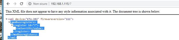

i have a similar problem:
i have this register:
whit this string:
String dato “Info [%s]” {http=“<[http://192.168.1.115/7:6000:XPATH(/[name()=‘modbusregisters’]/[name()=‘register’]/*[name()=‘value’])]”}
but doesn’t work can anyone help me please?

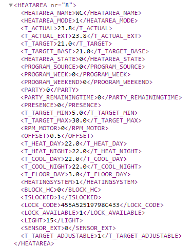

EDIT: Here a part of the XML i get form my Alpha.
Thank you, guys!
