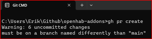

@florian-h05, I installed the Github CLI, and read up on the documentation (Creating a pull request - GitHub Docs). Although I don’t quite understand how that CLI knows to which repository I want to send this pull request… But I assumed that’ll become clear during the process.
But this gave me the following error:
Warning: 6 uncommitted changes
must be on a branch named differently than "main"
@florian-h05, I think I did it!
