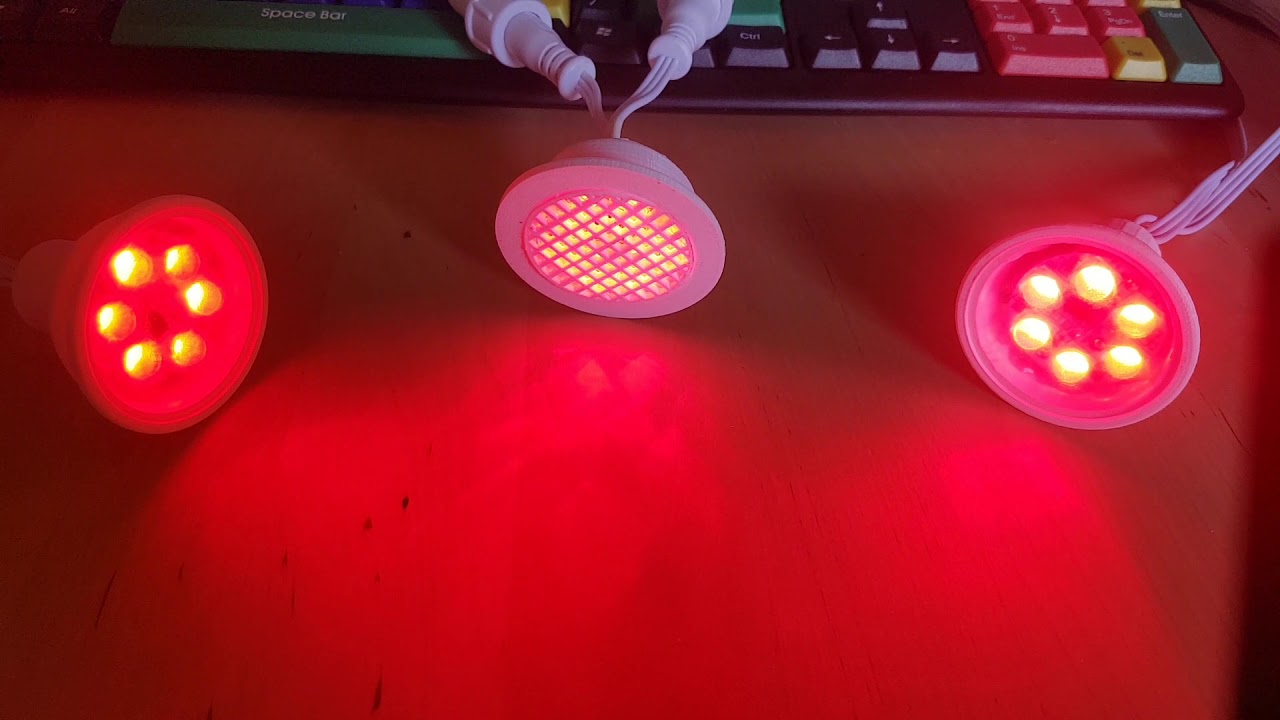

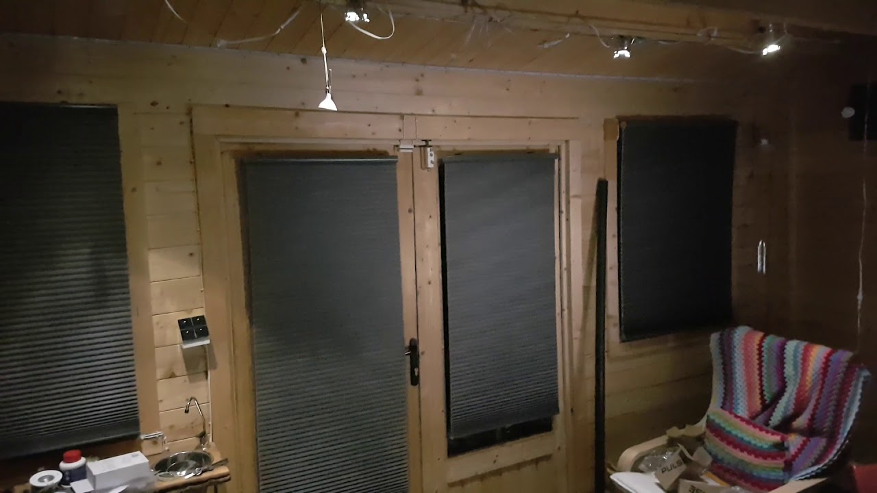

As a way to resolve this, I’ve built some individually addressable Par16 lamps based on SK6812 GRBW chips, that openHAB2 can drive with the DMX binding.
The second batch is about to be sent to a customer next week.
They are only 1Watt per lamps, so you’ll need more lamps to get a really bright area, but the point of them is that the dim curve is incredibly smooth and the low level truly low.
Whilst the colour temperature is completely tunable.
These videos show them in action -
