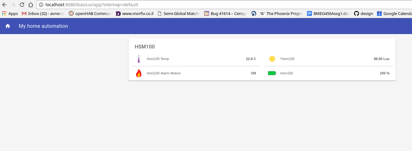

I tested the HSM 100 device and I think that it is working now.
I installed the zwave development binding (see note1) and verified that I can get motion, temperature, and lux events from the device (note2) as well as see them renderred in basicui (note3)
I’m still not clear about how to set the duration for motion alarm to be turned off (see the xml file in note4)
The device turned once from ON to OFF after ~30 min, but then it turned to ON and never back to OFF
Where would I see the duration parameter or other related parameters (e.g. poll period) in the xml file (see note4) or in PaperUI (see note5)?

note3 - HSM100 temerature, lux and motion alarm show up in basicui
