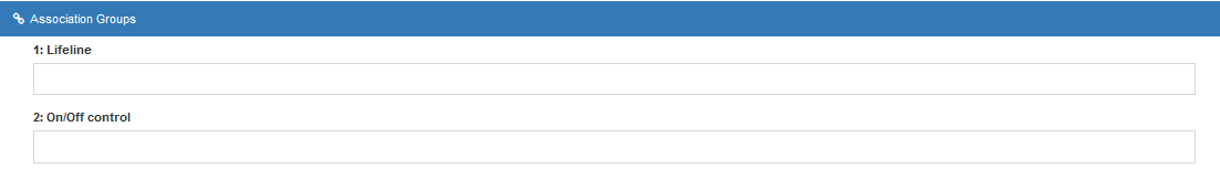

You will find the java exception at 12:23:54.679 .
It might be interesting to look a bit earlier into this log, but I really wonder how you have things configured? Looking at this short except - there are 25 messages received here in around 3/4 of a second (ie messages even 20 or 30 milliseconds!!!) -:
Lots of messages are duplicated - possibly because you have duplicated association settings (ie added the controller into multiple groups)? I’m not sure why else this is happening, but if you then try and do something intensive like include a device, or try and configure something, and with this VERY high loading, I’m not surprised that things will have a problem.
I just checked all 90 nodes. The controller is only in association group 1.
Ok - maybe it’s something else - maybe it’s just a few nodes that have a problem - if I look in the log, node 53 alone has 10 messages in the 3/4 of a second - node 51 is about the same, and node 53 is a bit less…
Something is wrong somewhere with these nodes or their configuration.

All the nodes in the logs (51,53,70) are thermostats (Heatit, TF016 by ThermoFloor). As they used to produce a lot of timeouts in the logs at the beginning I reduced polling for them to only 1x a day. Since then I do not see any timeouts for them in the logs anymore. They report quite often the actual temperature and the setpoint temperature.
Unfortunately they have Firmware 1.7 which has only 1 configuration parameter, so I do not see a way to change any configuration:
Ok - not sure what to suggest then. Maybe this was just a “one off” - I’d just keep an eye on the log to see if this sort of thing is really happening often or not…
Well, I have the logs from the last weeks in full detail. I just checked a few of them with the log viewer on your webpage right now. My thermostats seem to do this VERY OFTEN (repeating 30+ basic reports within 1 second). Could this be a source of instability for the network? I do not need frequent updates from them at all…
