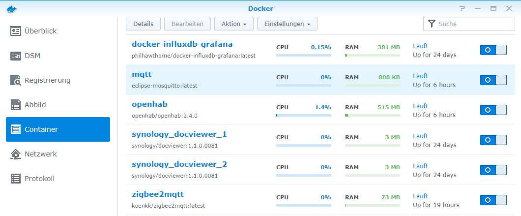

After some problems now run in the Docker container: Zigbee2Mqtt (koenkk) und MQTT (eclipse) on Port 1883).

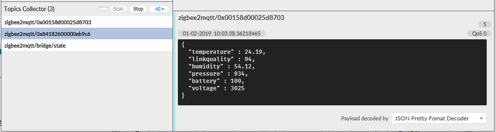

The following two devices are connected to the Zigbee2mqtt and seem to report the data.
0x00158d00025d8703 is the Aqara Temp Sensor
0x00158d00025d8703 is the Osram Plug

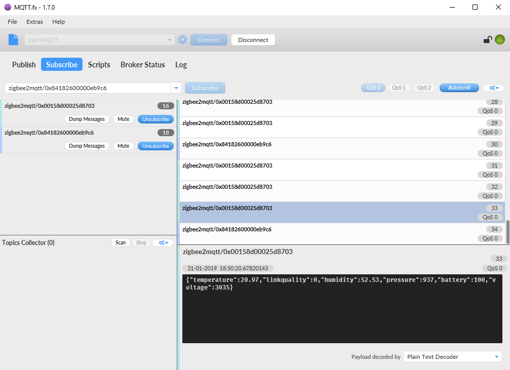

A connection to the MQTT Eclipse can be established via MQTT.fx. Both Puplish and Subscripe seem to work.

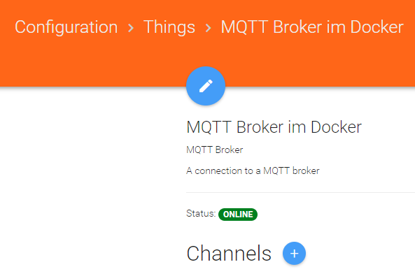

In OH2.4 both the binding is installed, and connected to the MQTT

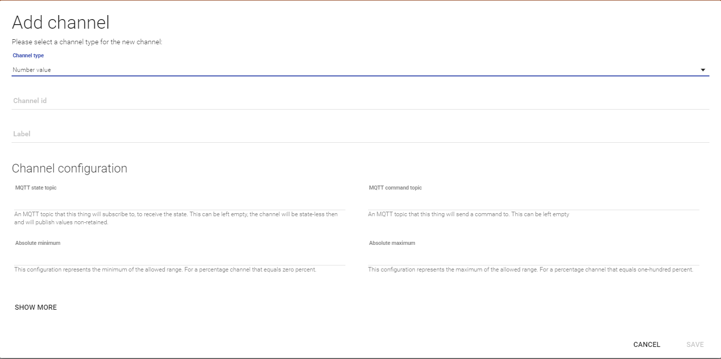

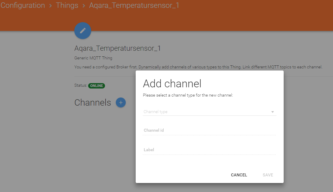

Now I’m trying to add a new THING, but I don’t know where to add what.
I would like to read the temperature from the sensor on the one hand and switch the Smart Plug on/off on the other hand. I am very grateful for help!

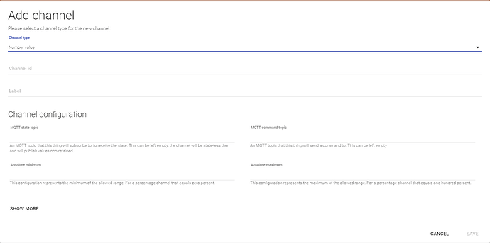

In short for a switch create an On/Off Type channel, for the temperature a number channel.
For both to report their respective state back the state topic has to be set, for the On/Off you need to set the commandtopic as well.
You do have the needed settings in your MQTTfx.
It’s not these settings. I had already read this out in the instructions.
can you show me how and where?
Subscribe to the statetopic “zigbee2mqtt…” and use “JSONPATH:$.temperature” as Incoming value transformation (found when clicking “show more”)
Sensational! OH pulls the data of the temperature sensor!!! T H A N K S :slight_smile:
