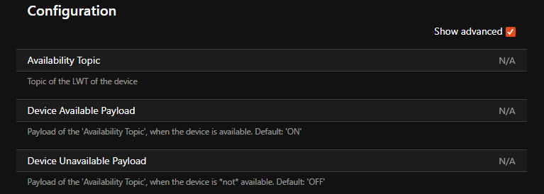

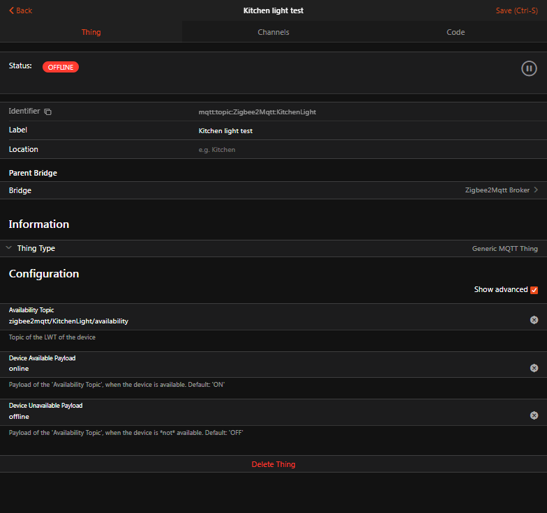

I cant make the thing work in the UI. I made a broker with the UI which goes online but the generic mqtt thing stays offline no matter if i select my text file generated broker or the UI generated one.
What am I missing here?

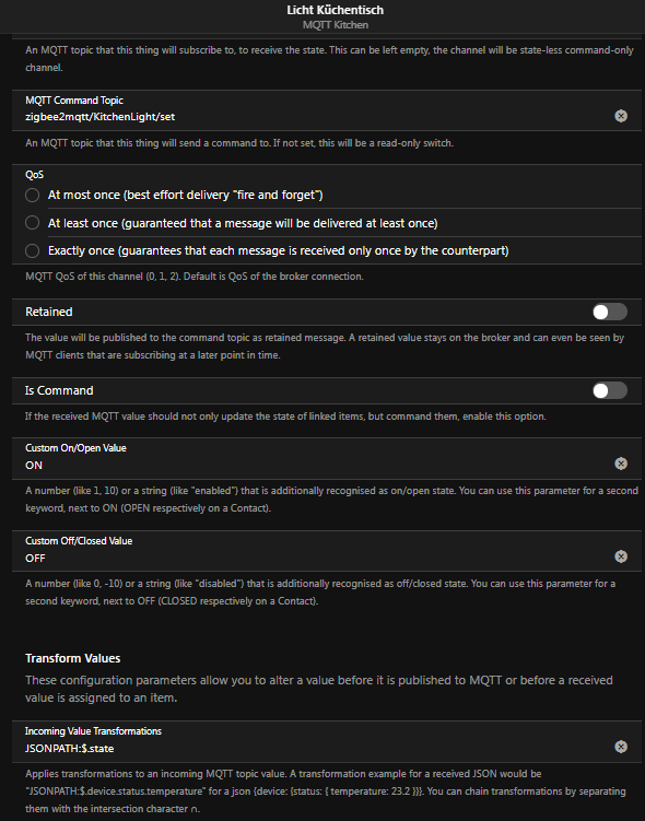

Then the UI generated generic mqtt thing “Kitchen Light Test” was online for a moment. I created the channel and linked it to an item all by the UI.
Now the thing and the channel are offline but the Item linked to it is working!? And it even updates when I change the state of the bulb unplug the bulb.

i did a reboot of openhab and now all is online and even the text file generated kitchen switch is reacting to manual manipulation of the bulb.
Now both switches change to ON a few seconds after power on the bulb.
What i forget to mention above is that i also added availability with 5 seconds to zigbee2mqtt configuration (before it was deactivated). So I still understand it completly but looks like availability has an effect here
