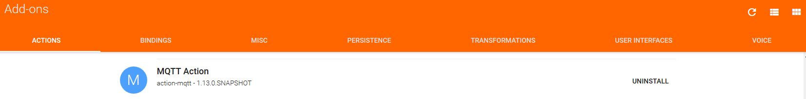

Next question, do you have the MQTT action installed?
Yes, the MQTT Binding is installed (PaperUI).
No, the MQTT action?

Go to PaperUI → Addons → Actions tab and see if it is installed:
It is installed NOW.
Do i have to configure anything for it?
Still not sending a MQTT Message (MQTT Lens)
