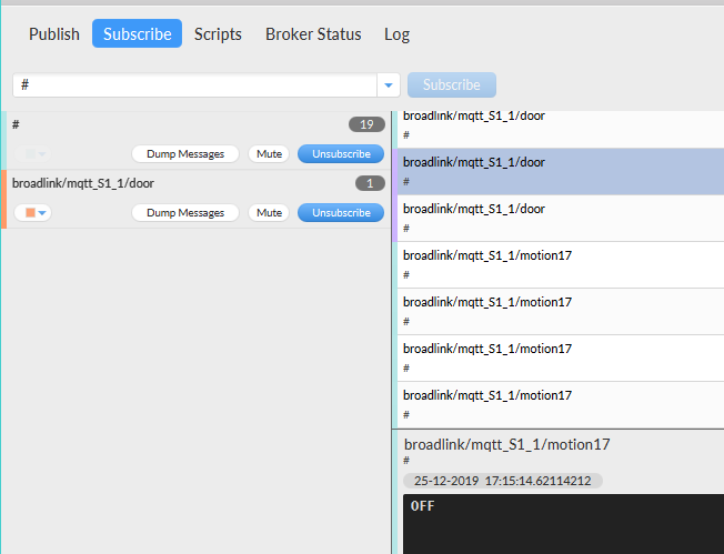

i will keep the MQTT server hosted in another PI
i have installed 2.5 release from scratch and the mqtt bindings
the service is starting but nothing is happening. i mean the incoming mqtt changes do not trigger openhab items changes
it was working in 2.4
Openhab is installed on 192.168.1.150
mqtt server is installed on 192.168.1.110
in the mqtt.cfg
i set :
mosquitto.url=tcp://192.168.1.110:1883
broker.url=tcp://192.168.1.110:1883 commented
my item:
Contact mqtt_sensor_door "S1-Door Sensor [%s]" (gHistory,gPresence,gDoor) ["object:door"] {mqtt="<[mosquitto:broadlink/mqtt_S1_1/door:state:default]"}
my mqtt server is well running
What i am missing
This is the syntax for the 1.x mqtt binding. Need to use syntax for the new 2.4 binding.
Here’s a guide to help with the changes. Sonoff Tasmota with MQTT Binding 2.4 (using config files)
