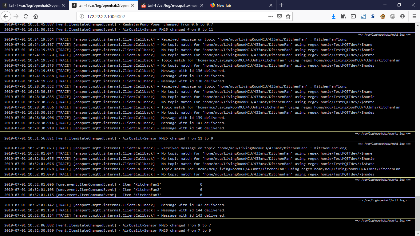

Check this out.
2019-07-01 10:22:39.599 [TRACE] [ansport.mqtt.internal.ClientCallback] - Received message on topic 'home/mcu/LivingRoomMCU/433mhz/KitchenFan' : KitchenFan*long
2019-07-01 10:22:39.603 [TRACE] [ansport.mqtt.internal.ClientCallback] - No topic match for 'home/mcu/LivingRoomMCU/433mhz/KitchenFan' using regex homie/TestMQTTdev/\$name
2019-07-01 10:22:39.604 [TRACE] [ansport.mqtt.internal.ClientCallback] - No topic match for 'home/mcu/LivingRoomMCU/433mhz/KitchenFan' using regex homie/TestMQTTdev/\$homie
2019-07-01 10:22:39.606 [TRACE] [ansport.mqtt.internal.ClientCallback] - No topic match for 'home/mcu/LivingRoomMCU/433mhz/KitchenFan' using regex homie/TestMQTTdev/\$state
2019-07-01 10:22:39.607 [TRACE] [ansport.mqtt.internal.ClientCallback] - Topic match for 'home/mcu/LivingRoomMCU/433mhz/KitchenFan' using regex home/mcu/LivingRoomMCU/433mhz/KitchenFan
2019-07-01 10:22:39.609 [TRACE] [ansport.mqtt.internal.ClientCallback] - No topic match for 'home/mcu/LivingRoomMCU/433mhz/KitchenFan' using regex homie/TestMQTTdev/\$nodes
2019-07-01 10:22:39.703 [TRACE] [ansport.mqtt.internal.ClientCallback] - Message with id 133 delivered.
2019-07-01 10:22:39.726 [TRACE] [ansport.mqtt.internal.ClientCallback] - Message with id 134 delivered.
2019-07-01 10:22:39.752 [TRACE] [ansport.mqtt.internal.ClientCallback] - Message with id 135 delivered.
That’s the one you meant isn’t it?

2019-07-01 11:20:41.335 [TRACE] [ansport.mqtt.internal.ClientCallback] - Received message on topic 'home/mcu/LivingRoomMCU/433mhz/KitchenFan' : KitchenFan*long
2019-07-01 11:20:41.336 [TRACE] [ansport.mqtt.internal.ClientCallback] - No topic match for 'home/mcu/LivingRoomMCU/433mhz/KitchenFan' using regex homie/TestMQTTdev/\$name
2019-07-01 11:20:41.337 [TRACE] [ansport.mqtt.internal.ClientCallback] - No topic match for 'home/mcu/LivingRoomMCU/433mhz/KitchenFan' using regex homie/TestMQTTdev/\$homie
2019-07-01 11:20:41.339 [TRACE] [ansport.mqtt.internal.ClientCallback] - No topic match for 'home/mcu/LivingRoomMCU/433mhz/KitchenFan' using regex homie/TestMQTTdev/\$state
2019-07-01 11:20:41.340 [TRACE] [ansport.mqtt.internal.ClientCallback] - Topic match for 'home/mcu/LivingRoomMCU/433mhz/KitchenFan' using regex home/mcu/LivingRoomMCU/433mhz/KitchenFan
2019-07-01 11:20:41.341 [TRACE] [ansport.mqtt.internal.ClientCallback] - No topic match for 'home/mcu/LivingRoomMCU/433mhz/KitchenFan' using regex homie/TestMQTTdev/\$nodes
2019-07-01 11:20:41.473 [TRACE] [ansport.mqtt.internal.ClientCallback] - Message with id 158 delivered.
2019-07-01 11:20:41.487 [TRACE] [ansport.mqtt.internal.ClientCallback] - Message with id 159 delivered.
2019-07-01 11:20:41.498 [TRACE] [ansport.mqtt.internal.ClientCallback] - Message with id 160 delivered.
It seems that the org.eclipse.smarthome.io.transport.mqtt shows unsubscribes but not subscribes. Still, mosquittos own logging shows it, so let’s see what happens. Will leave this for now and keep working on my homie v3 esp8266 code. :slight_smile:

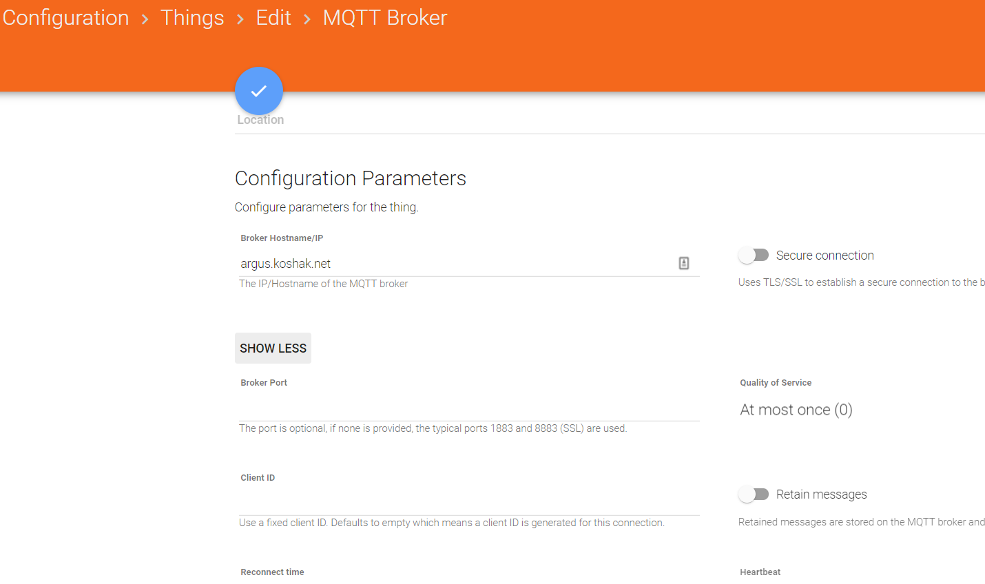

Are all of your client IDs unique? If not, when a client with the same ID as a client already connected to the broker subscribes, the broker kicks off the old client in favor of the new one. All your clients must have a unique client ID. Do not confuse the client ID with the user ID. You can reuse the same user ID everywhere.
I can’t tell if this is what you are experiencing of not but it sounds like a possibility.
What QOS are you using? If it’s zero I could see that if they come in too fast the broker might just drop them if it can’t process them fast enough. Or it could be the case that the AsyncMqttClient doesn’t have the ability to queue up the messages so if you send a new message before the last one gets published to the broker the old one gets overwritten.
It appears like it, at least in terms of openHAB and Homie.
Don’t confuse the standard Homie with implementations of the standard. The standard is actually pretty mature. The implementations of it are not as mature.
Please file an issue on the openhab2-addons as well so it can get fixed in openHAB too.
I know a lot of people are using Homie with openHAB though and this is the first report of a problem like this so it isn’t clear to me what’s unique about your use case yet. Clearly there is something going on.
It can’t but the person might. I think rossko57 is just suggesting double checking you haven’t accidentally used “home” where you should have used “homie” and vise versa.
That’s a very good point! I actually don’t know where to look up the client ID for MQTT things after they were created. I looked around for it for a while now, in both paperui and habmin, i don’t think the option is there other than when you first create the item.. it doesn’t even show it anywhere afterwards, let alone edit.
But, I stuck with the default 32-bit hex value (never edited it) and i deleted and recreated the homie mqtt things several times. They would have gotten a new random client ID every time.

I don’t use Homie yet so I only have Generic Things right now. But that shouldn’t matter because the client ID I believe is set on the Broker Thing. It’s there under “Show More” for the Broker Thing config in PaperUI. The broker represents the connection to the MQTT Broker and the client ID is defined on a connection by connection basis so I wouldn’t expect it be possible to supply a client ID on a Generic Thing or Homie Thing.
The question is does the Homie Things use a different Broker Thing?
The client ID that gets generated automatically when you don’t supply one is generated by the Paho library.
Don’t confuse the client ID on the Broker Thing with the Channel ID.
When I started making my first Homie device just as a test, by manually publishing the right values, and saw it automatically pop up in the inbox, I knew it was the right way to go for me.
Ah!
They do now because that was the only workaround I found for the bug. Normally they would be using the same broker thing, of course.
I ran across the bug when they were using the same broker thing (it’s the same mosquitto broker so of course i did not create a new broker thing willy nilly). So, there was only one client ID. Obviously one should be able to have more than one subscription (to different things, mind you) on the same broker thing? :slight_smile:
Technically I was confusing the “Thing ID” with the client ID on the broker thing :wink:
The MQTT Homie part is broken in openHAB 2.5m1. It has several subscribe/resubscribe issues. Fixes are merged since a few months already, but we didn’t had a release since then.
