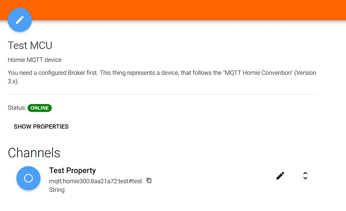

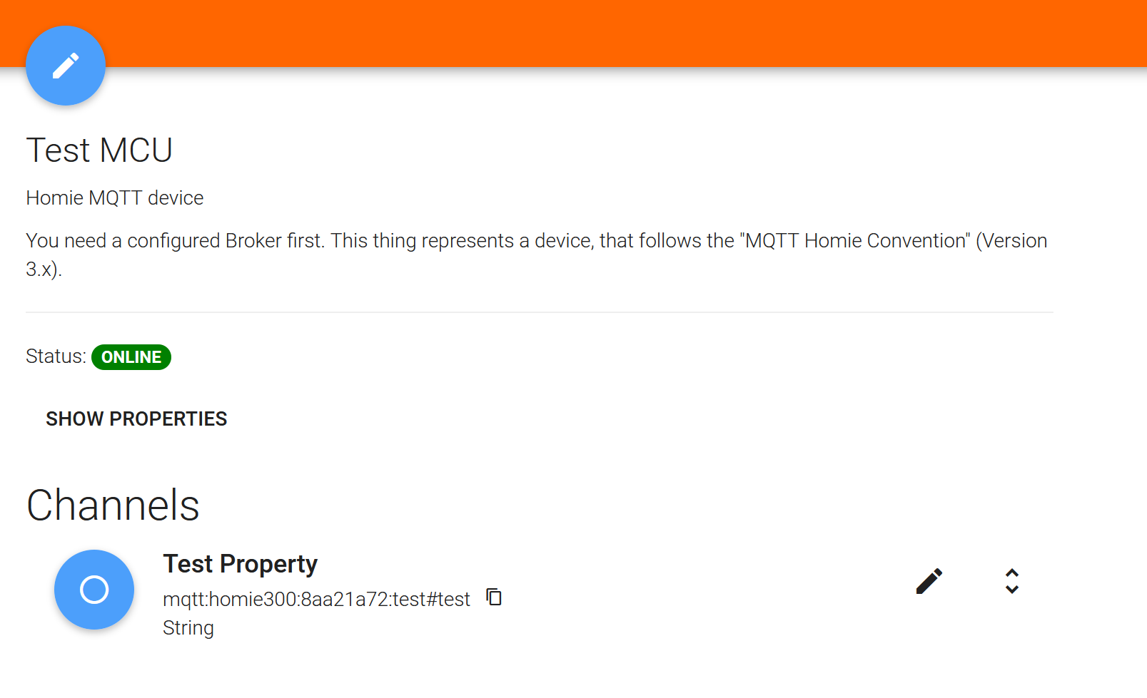

This morning I started feeling like I was chasing my tail. I was having no luck getting anything to work. Finally I decided I needed an openHAB LAB setup so that I don’t have to experiment on my production system now that I am relying on it. That has taken all day, but I finally now have Homie items updating Basic UI items! Slow progress, but progress nonetheless.
Hm. Ok. That needs investigation. In theory it’s possible. They all share the same mqtt connection object if the same mqtt bridge thing is used.
Hey, an offline Homie Device will also kill subscription for other homie devices on the same MQTT broker connection. I don’t know how anyone missed this!
To reproduce:
Use two separate Homie Devices added as things.
Make sure openHAB responds to messages from both.
Then change the device ID of homie device A, so that it shows as offline.
BOTH are now broken, not just the one you changed.
Change the device ID of homie device A back so that it shows as online.
Note how device A now works but device B is still broken until you disable and re-enable it.

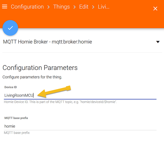

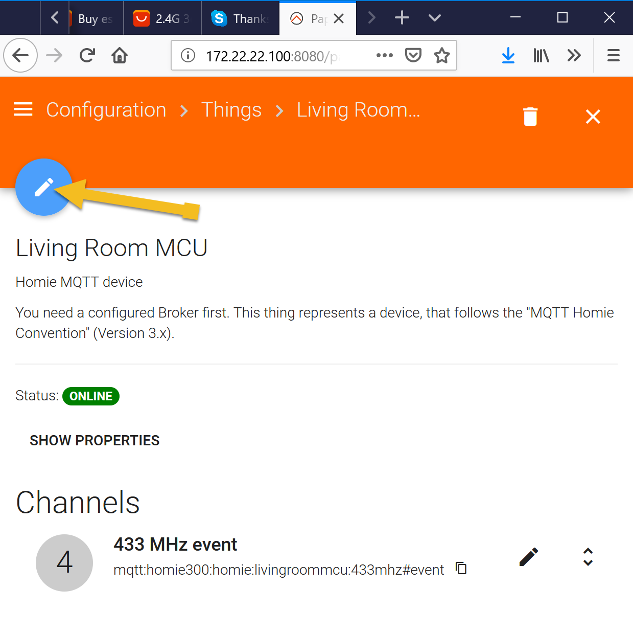

Just to be safe … what is thing ID of the bystander casualty? Is it related/same as β€œHomie device ID”? PaperUI hides this stuff mostly, REST API might be clearer.
The bystander casualty (what an excellent description!) is:
mqtt:homie300:homie:livingroommcu
The Homie device ID is
LivingRoomMCU
Previously, the homie device ID was:
livingroommcu
I changed it a few hours ago because I realized it would look better in the MQTT tree.
So they were the same before, but I would say they are not the same now, since MQTT is case sensitive. In any case they are both killed.
Also please note that previously (while I was still developing my homie library), my other devices were generic MQTT things, and they still got slaughtered. I only had one homie device at the time – the one I was developing. So, with the available data, I thought Homie devices killed generic devices, which made is kind of understandable that one might not notice the bug.
But, now that my homie library is usable, I turned my existing generic devices into homie devices.. and with that I now notice that Homie things kill other MQTT subscriptions indiscriminately, whether from a homie device or a generic device. That tells me it’s probably at the broker level. I wouldn’t be surprised if it killed HASS thing subscriptions too.
With my limited understanding, the only way for an MQTT Thing to be marked as offline is if the Broker Thing get’s marked as offline. With Generic Things we create a separate Broker Thing. Do you need to create a Broker Thing for Homie too or is it all embedded in the one Homie Thing? Maybe it’s there but hidden?
hmm, not so sure about OH though.
Your screenshot shows PaperUI identifying the Thing as
I’m guessing that is auto derived from the Homie supplied info LivingRoomMCU?
I mooched at the Homie spec and it’s a bit unclear whether uppercase is allowed in β€œdevice ID”
Actually it wasn’t. The binding didn’t derive anything – the default thing ID is a actually a random 32-bit hex string (such as 8aa21a72). That’s one of the many things that could be a lot more user friendly, because:
  • The thing ID is important – it’s going to be used as part of every channel identifier
  • You’re going to be typing it in every script or rule that uses data from a homie device
  • It can’t be changed. If you make a mistake you have to delete the thing and start over!
You know, now that you mention it, I guess the homie spec does not specifically allow upper case characters. It doesn’t prohibit them but it is implied that only what is specifically listed is allowed… dang it.
It’s working as well with upper case thing id’s as it did with lower case (and it’s certainly easier to read), but I really don’t feel like taking the chance that I’d have to change all the host names if this is ever enforced in a future version, so I guess I’ll go write a CamelCase to hyphen routine…
Why it doesn’t is a mystery - stupidly overly restrictive I feel - I just lowercase the lot.
