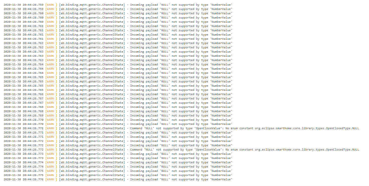

MQTT JSONPATH Issue with changing exising values to null
Im having an issue with ZbBridge running tasmota. I have a number of devices registered to the bridge but they all send updates on the same MQTT publish path.
When it publishes on this path
tele/tasmota_zbGateway1/SENSOR = {“ZbReceived”:{“0x7294”:{“Device”:“0x7294”,“Name”:" Office_Temp",“Temperature”:23.88,“Humidity”:65.49,“Endpoint”:1,“LinkQuality”:157}}}
I get my temperature updated in openhab and it works fine until another device updates.
tele/tasmota_zbGateway1/SENSOR = {“ZbReceived”:{“0xFF6C”:{“Device”:“0xFF6C”,“Name”:" Wardrobe_PIR",“Illuminance”:6,“Occupancy”:1,“Endpoint”:1,“LinkQuality”:13}}}
At this point the first temp value goes to null as it received an update on the published path but there was no entry for the temperature so in openhab they all go blank.
My Items are as follows any help would be great as there are no errors listed in the logs.

It looks like you are using the V1 MQTT binding, rather than V2. Did you mean to do that? If you’re just starting you should use V2, as for configuration will then be valid for the upcoming openHAB 3.
Assuming you change to the V2 binding, you can chain two transformations together: REGEX first then JSONPATH. See: MQTT 2.5 M1+ How to implement the equivalent to MQTT1 REGEX filters
Yes im using V1 binding but i cant see how V2 will fix this issue, Is this working as expected? If a Json message does not include a value for an item does OPENHAB then change it to null?
It doesn’t change it to null for me - openHAB just complains with a warning in the logs, but leaves the existing value of the Item alone.

No it doesn’t.
I don’t think it would actually move us any further forward, but the ‘void’ state for an Item is either NULL or UNDEF.
NULL usually signifies the Item has been reinitialized for some reason, while UNDEF is generally what a binding should set to indicate “unknowable” because there was bad comms or suchlike. So it can be useful distinguishing which exactly.
However I would not like to assume v1 MQTT binding follows these guidelines. Your events.log should show you what is really going on, but I don’t think it helps.

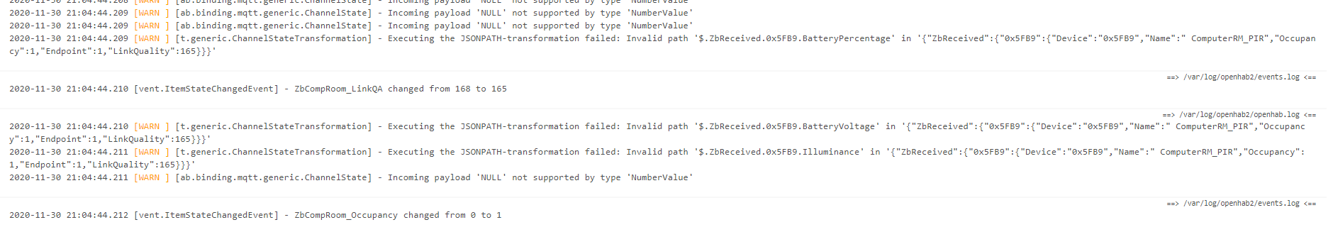

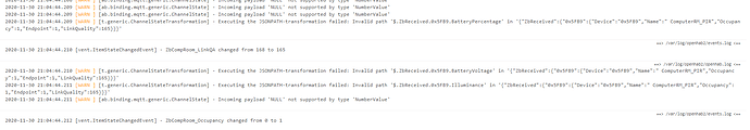

Hi, i have tried adding the REGEX to my transforms but still get errors in the logs when anything updates.
can you please confirm the character between the ) and the JSON also?
Also once the REGEX is working i think i get

You have an invalid path in the json string
If it can’t find the path that is the error
It can’t find BatteryVoltage in the pir because tasmota is not sending the data
For some reason when i take the ZbReceived out of the JSON path the errors go away so i have removed this and no all of the errors look to have gone.

Thanks denominator the option 89 has 100% fixed the issue i have no more errors in the logs anymore.
