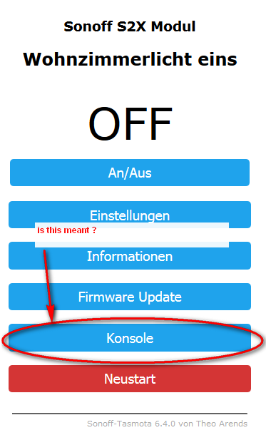

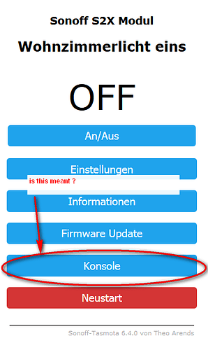

What console?
How do you monitor you MQTT messages?
Do you mean the Web-Interface of your Sonoff, when your talking about console ?

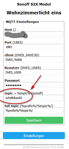

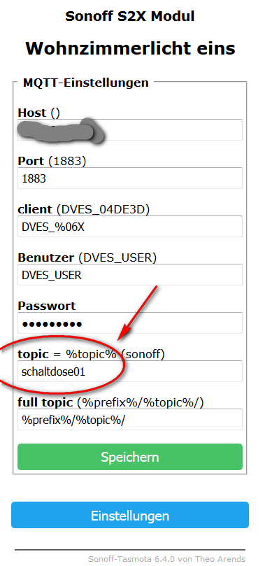

and of course you can not use my mqtt-command one by one, you have to change the name(topic) of the sonoff you are using. You find this information here:

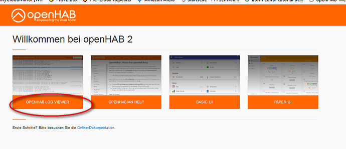

Or do you mean the Log-Viewer (logger) of your Openhab-Web-Interface
