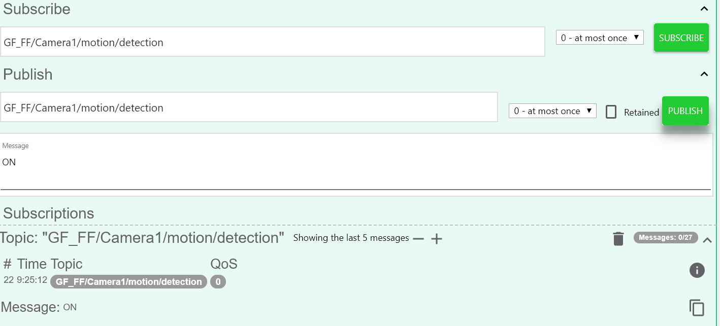

I need your help with a switch item and mqtt. I have a Xiaomi Dafang Camera and installed following hack:
Contribute to EliasKotlyar/Xiaomi-Dafang-Hacks development by creating an account on GitHub.
I want use mqtt for the settings, but my switch item does not work.
Switch GF_Camera1_Motion “Camera1 Motion” (EnergyValues) {mqtt=“>[mosquitto:GF_FF/Camera1/motion/detection:command:*:default], >[mosquitto:GF_FF/Camera1/motion/detection:state:default]”}
MQTT Lens shows:
The log shows:
Thank you in advance!

Switch GF_Camera1_Motion “Camera1 Motion” (EnergyValues) {mqtt=">[mosquitto:GF_FF/Camera1/motion/detection:command:*:default], >[mosquitto:GF_FF/Camera1/motion/detection:state:default]"}
The MQTT binding information uses “> ” twice. Try changing the second “> ” to “< ”.
Switch GF_Camera1_Motion “Camera1 Motion” (EnergyValues) {mqtt=">[mosquitto:GF_FF/Camera1/motion/detection:command:*:default], <[mosquitto:GF_FF/Camera1/motion/detection:state:default]"}
A question for you, what kind of motion detector is this that accepts commands? In other words, when you send it “ON”, what does it do with that command?
Would a Contact Item correctly represent the Dafang’s motion detector?
