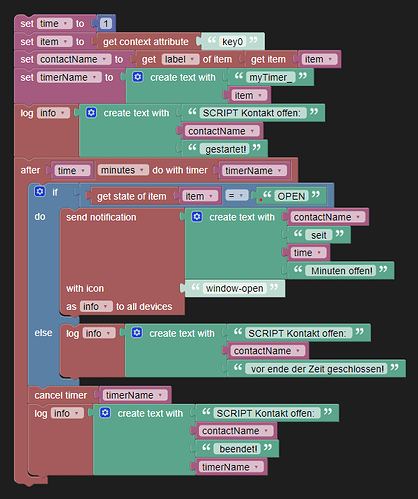

I want to write a blockly script that notifies me when a window contact is open for a specific time.
The script is to be called up via several rules for different windows. For this I pass the item of the contact to the script as a parameter. Unfortunately, the first call of “cancel timer” seems to end all script timers or the timerName is overwritten by the last call.
Is there a solution to the problem?

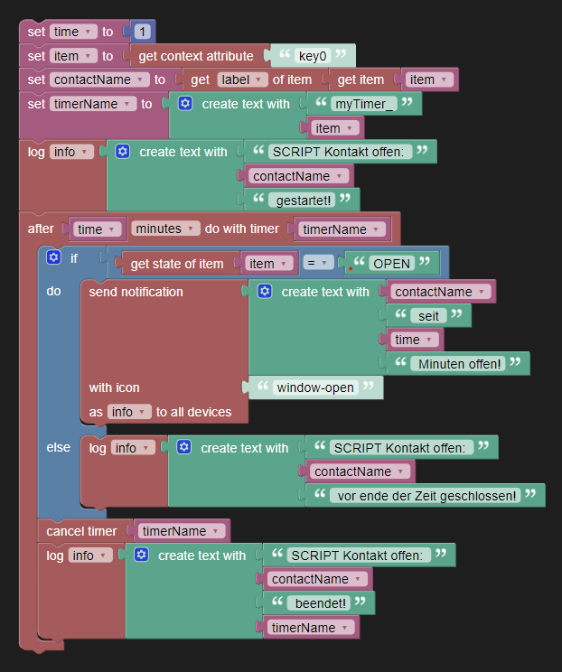

here ist what I did:
The issue is, that even e.g. you have two instances of the timer running you only have one instance of the item & contact name variable and once a new timer is starting your variables value will change.
The only way I know to accommodate this issue is to pass additional arguments to the timer.
I have resolved it by creating a new timer block that will keep the original event context (link). However this is only working if the blocky code is directly called from a rule and not as a script by another rule. maybe you need some further adjustments if you want to use it within a script triggered by a rule
Indeed, timerName gets overwritten every time this script gets called. So when the timer goes off, it will cancel the last timer that was created, not necessarily the current timer.
But it makes no sense to cancel a timer inside itself. The fact that the code is running means that the timer has already terminated. There’s nothing to cancel. So get rid of that cancel timer and I think that should fix things.
