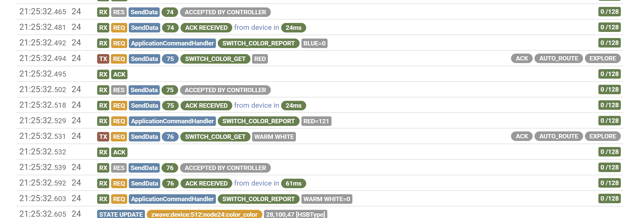

So original log
retry hidden in here
again direct but then 61ms
